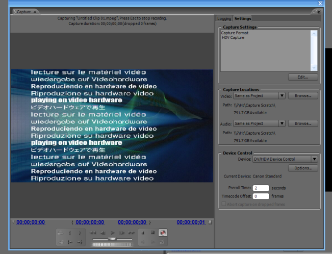

Capture problem: Canon HDV to PremPro CS3
Hi gang! Yesterday I shot a wedding with my xh-a1 in HDV. This was my first HD shoot (usually shot in SD with my xl2 in tandem) so today I was trying to capture the footage and got the "blue screen of death" with all the different languages saying "playing on video hardware." I don't have any trouble with SD footage...what is this error screen telling me? Attached is a screen shot.
Thanks in advance for your guidance!
Terry Wall

Can you clarify: do you mean you got a BSOD at some point after starting capture? For reasons known only to Adobe, they do not display HDV video as its captured. You have to look at the source device's display (your camera's LCD) and the screenshot you posted is normal during HDV capture.

Pete, you are correct! I went back into capture mode and save a sample clip of the HDV footage, and sure enough, it captured and I was then able to preview the clip on my source monitor. So would someone please explain to me why Adobe would do something so boneheaded as to NOT allow captured footage to play on the CAPTURE MONITOR??!!?? Is there anything in Adobe's (alledged) Knowledge Base that explains this? Call me crazy...this is just dumb! Are these folks arrogant enough to think that we PC users just might try out some other NLE?? Or do they have such a large user base that they just don't care?

When HDV first came out, the general presumption (and I don't recall if Adobe did or did not say so) was that they wanted to reduce the chance of dropped frames if system resources got maxxed out. Nowadays, with much faster computers being the norm I doubt anyone would accept that rationale, but for whatever reason capture window display of HDV has never gotten into PPro.
Every time I do an HDV capture, I also wonder why they haven't bothered to fix this. But, to me it is a minor nuisance that doesn't really slow anything down (any more than tape capture inherently does, anyway!)
Glad your captures are actually ok.

No, in CS5 you still need to view the video on your camcorder during capture. But as I mentioned, I consider it a quirky mystery and not anything that really affects workflow. If you want to switch to Vegas or a Mac, that's entirely a personal choice. I can't compare because I've never used Vegas or FCP, but I'm extremely happy with CS5; it is the best version by far of PPro to date.

I think one reason it wasn't "fixed" is that Adobe doesn't consider it to be 'broken;" it simply isn't a real issue. Sure, it's a surprise -- it was to me -- to not have the monitor playback during capture if you're used to seeing it in DV mode, but the monitor window is too small and low-res for it to be of any real use anyway. If you're capturing from tape, you should have your capture device hooked up -- preferably via HDMI -- to a proper full size TV monitor so you can accurately judge sharpness, color, exposure, etc. while capturing to know whether the take is good or not. And it works fine for marking in and out points prior to the actual capture, so I'm not sure what advantage there is to seeing the tape while the capture process is underway.
But I'm guessing that everyone perceives HDV tape to be on the downward slope of its life bell curve anyway, so I'm not surprised Adobe decided to not put too many resources into tackling what is not more than an annoyance which doesn't truly affect functionality.
(And it's not a secret that HDV doesn't display during capture -- it's in all the documentation.)
