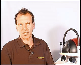

Recently I have shot some interviews for a short video clip. In my haste (and inexpertise!) I think I forgot to put the white balance onto the correct setting.
I have attached a screen shot of the problem clip.
Using Premiere Pro 1.5 I would love to know how to put this right. I have never done any colour corrction before and in my attempts all I can seem to do is make it look worse.
If any kind soul out there could offer me a noddy guide on how to make this look better then I would be enternally greatful.
Thanks in advance...

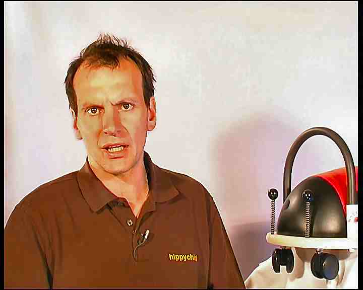

Is this any better?
I don't use Prem - SONY Vegas here. But I did do this quickly in PaintShop just to get your feedback.
If you wish to take this further please email me - yeah? I'm based in London . . .so!
Regards,
Grazie

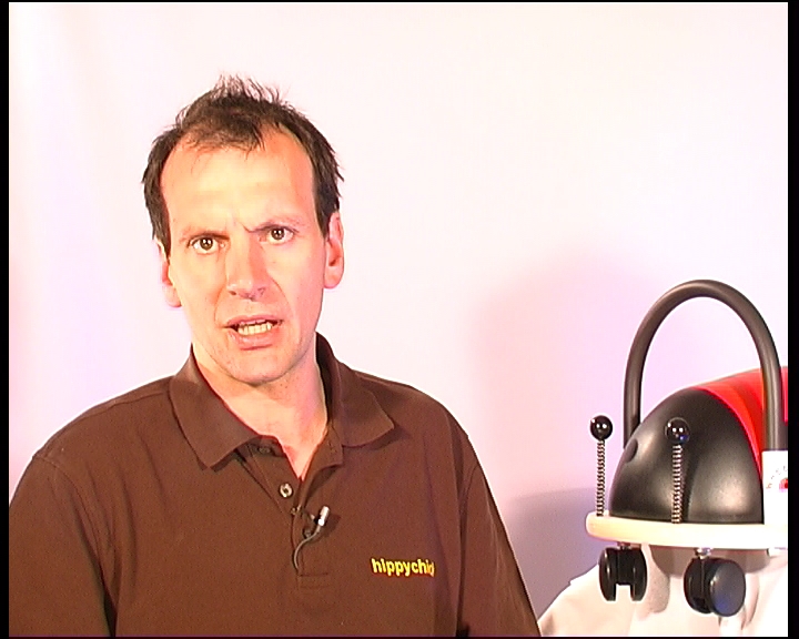

Your original has too many reds + no mids. This is what I did.
1) Using the vectorscope as a guide, I used the master hue offest to shift the reds into the "safe zone"
2) Using the luma corector (P-pro 2) I just lowered the master gamma + lowered the contrast a bit.
3) Finally, I used the RGB curves - using the master, I stretched the blacks a bit.
You lose a bit of detail - but get some decent color back. It's a bit easier on the eyes too.
Tim

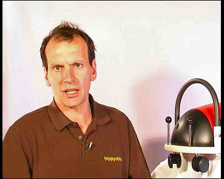

I took a crack at it with photoshop... you can do the same thing in After Effects, but not necessarily Premiere Pro.
What I did was just replace the color in the man's face with flesh tone color. The way to do this in AE would be to key the man's flesh tone out. Then on an upper layer, make it flesh tone color and set the composite mode to "color".
(Sorry, this is a really really brief description. Ask for details. I also glossed over some things like using levels to set a basic white balance.)
2- I'm not sure, but part of the problem may be that the image is slightly overexposed.
3- If you look at the shadow, it's purple/magenta comapred to the wall around it. It seems to indicate that the subject was lit with mixed color temperatures (the light is different colors). Yellow/magenta is usually a combination to avoid.
4- If you feel like it, you can isolate the magenta color and use it to adjust the lighting on the man's face. Use the hue/saturation filter, select magentas, expand out the selection/isolate, and drop the lightness setting. The image on the right shows the result. Incidentally, the magenta cast is not very visible anymore.
I have no idea why that works... it might be a combination of how the HSL color space works and how human vision works. That shadow is definitely red/magenta, but doesn't appear so.

Thanks Graham,
That does look better although as I am using a laptop (Dell Inspiron 510m) I am not convinced the screen helps me see it properly anyway..
