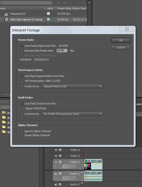

Hi all, I need to make a 24p timeline that will have quite a bit of 60i in it. What is the best way to make the 60i play normally or like the 24p at regular speed? Thanks TAG

Use the interpret footage feature ...right click on the clip in the browser, select interpret footage, change as needed: Adobe Premiere Pro CS4 * Modifying clip properties with Interpret Footage The jpeg shows what the screen looks like, with a 1080 60i original conformed...you may or may not want to change the aspect ratio, field order, etc, but this is where you can do it...hth/ Battle Vaughan
