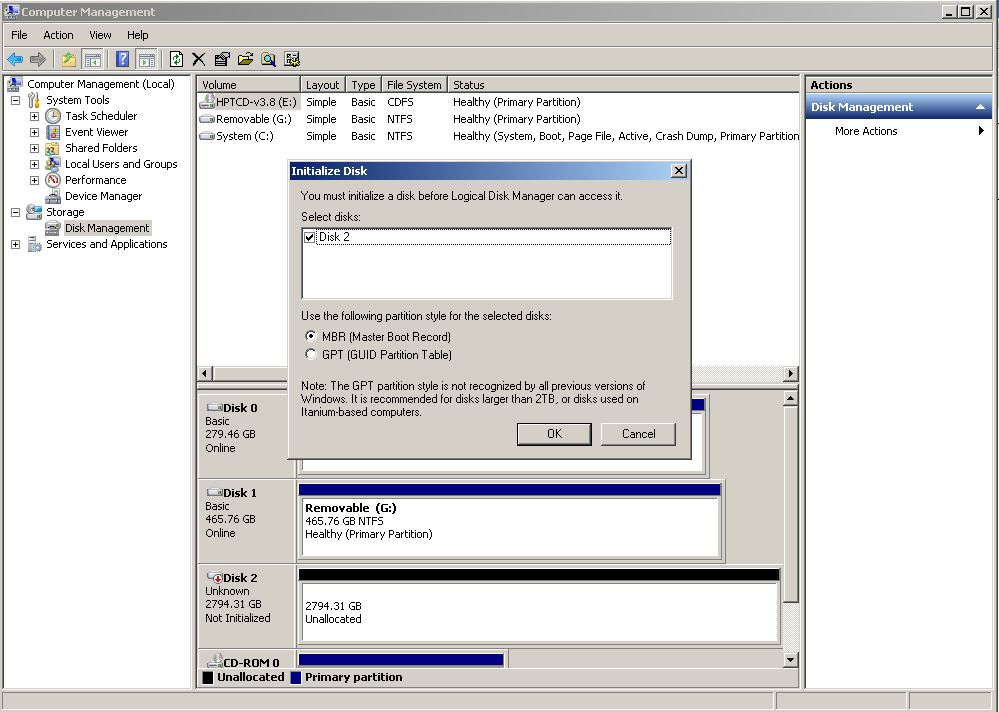

Good news - the controller arrived today!
Bad news: It took about three hours for me to get it working. First of all, the power supply is too big to allow the thing to fit properly in the only slot it will fit in. And in that slot, it doesn't even reach the gap in the rear wall - not that it needs to. Then I plugged it in and had to play around in the BIOS for ages to get the right combination of SATA RAID, Enhanced/Compatible/AHCI options that would let it load without blue screening as it got to Windows... I still don't know if I've done it correctly...
Worst news: I just don't know if there's any real significant improvement.
At this stage, there are three 1TB drives in RAID 0.

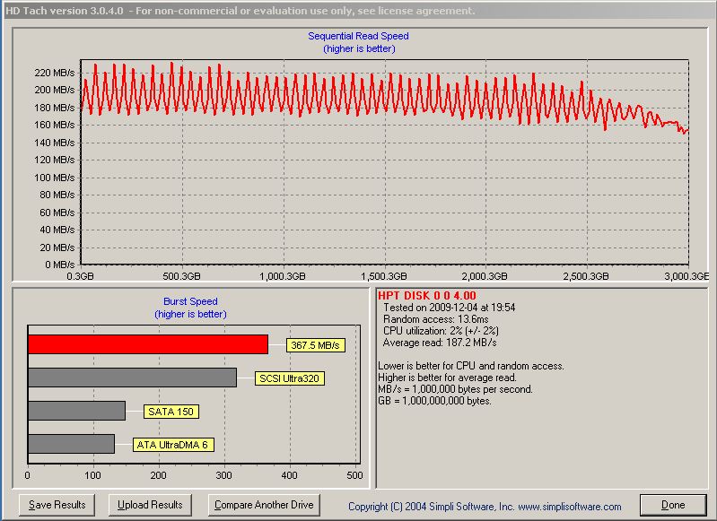

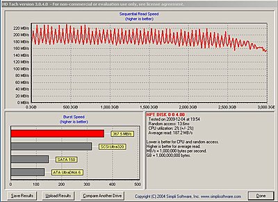

PPBM:
68, secs Total Benchmark Time
2.6, secs AVI Encoding Time
35.4, secs MPEG Elapsed Time
30, secs Rendering Time

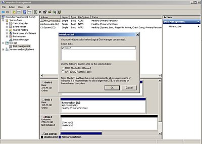

I've attached the HD Tach score and the screen grab from Disk Management where it asked me how I wanted to format the disk. I chose the second one as advised given that the volume size is over 2TB. Is that right? And how about Sector Size? It defaults to 512B. Is that what I want? It says if I change that it may have adverse effects... Should I try a few BIOS combinations?
Help Needed Improving my PP4 Benchmark Results-raid.jpg   Help Needed Improving my PP4 Benchmark Results-raid2.jpg

John, did you get the PCI Express "x4" or "x1" - I think the model #s are 2640x4 and 2640x1.
What stripe size did you use? 128, 64, 32?
Harm and anyone else: I remember reading that either HD Tach or HD Tune has a max size it can test, either 1TB or 2TB. I am trying to find more info in the mean time.
EDIT: Its HD Tune and random access. "It is becoming clear that HDTune is getting long in the tooth. HDTune's random access test appears to use 32 bit signed integers, meaning it only accesses the first 2^31 sectors when performing its test. This means it treats a 2 TB drive as a 1024 GB drive" from pcper.com

I got the x4 card.

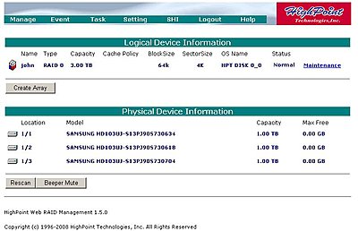

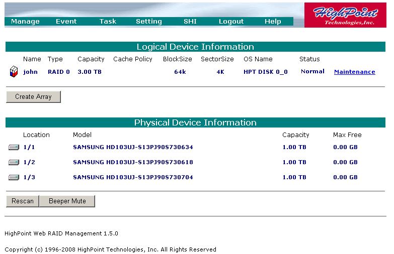

At no point was I asked to configure stripe size - I am asked for Block Size, but it forces me to use 64. Are they the same thing? I can also select Sector Size, which defaults to 512B. I tried that as well as 4K. Don't know which is better...

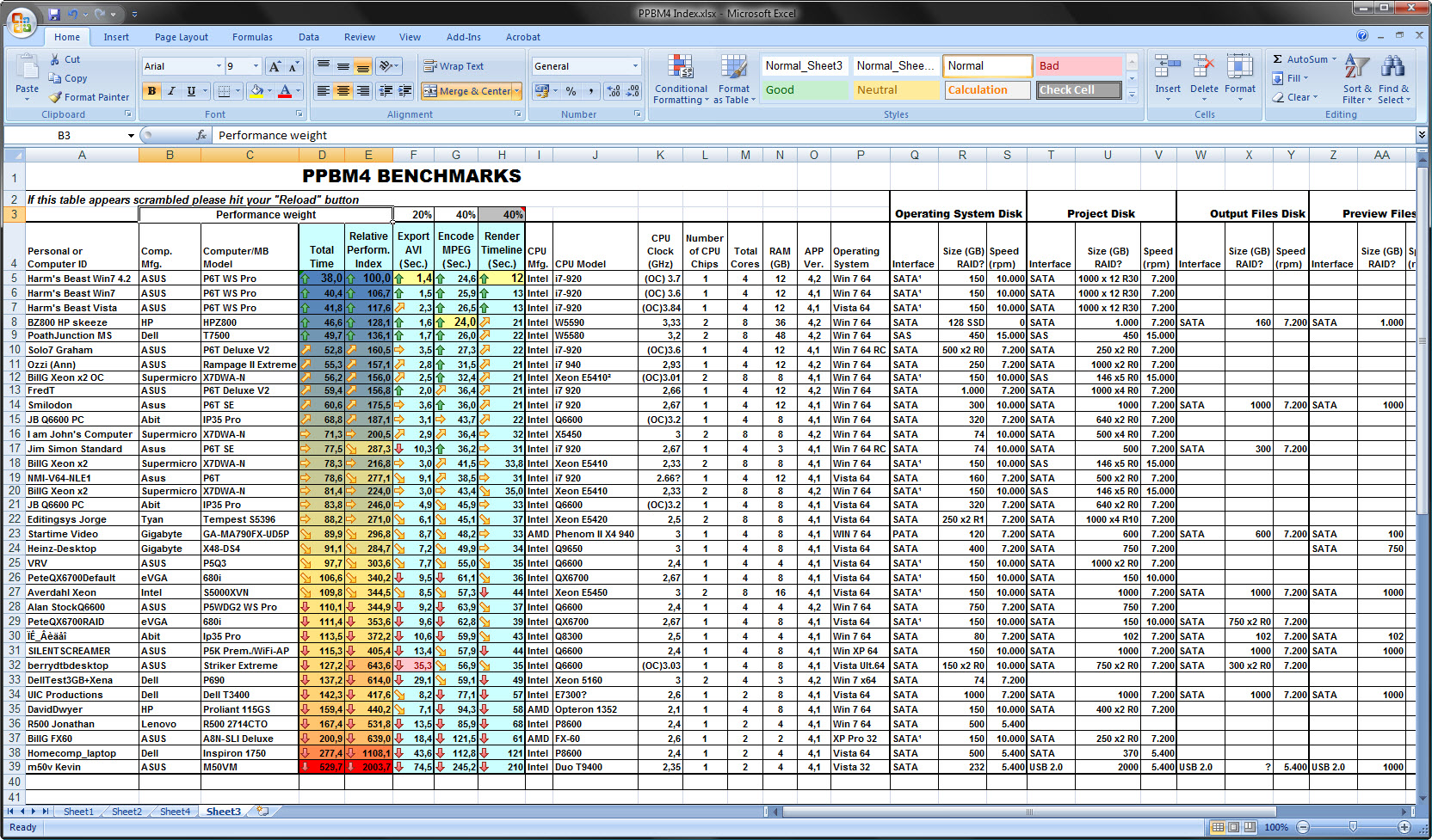

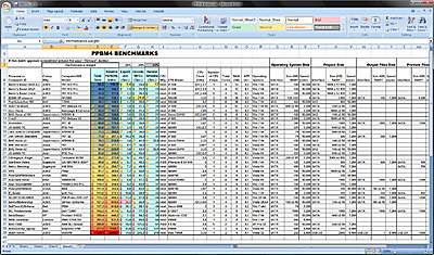

Maybe Bill will enhance the PPBM4 results with a RPI (Relative Performance Index) and add some readability enhancements that I suggested.
In essence it adds a more balanced index to view your results in comparison to other systems.
An overview is attached for your information. Again, Bill likes the idea but no guarantees that he will implement the changes I proposed.
With these enhancements you can see that your system performs in the upper quartile of all the results submitted on both the AVI test and the MPEG encoding test (as shown by the upward sloping arrow), but performs around the median on the Render test, and the same applies to both the Total Time and the RPI.
The cause of this result may be the relatively limited RAM for a dual CPU system, but still is pretty decent. If you look for instance at Jim Simon's results, you see that his RPI is significantly lower and mostly suffers from inadequate disk setup.
Hope this helps you in putting things in perspective. And I am glad you sorted out the DVD burner issue.

Ham, I must admit I am as confused as I've ever been by your version of the benchmark results. I like the colours! But the performance index and the arrows are over my head. My performance index is 200 - does that mean it's exactly half as good as yours? ;)
I can't believe how much I've had to learn about computers just to be a video editor - most of it from Harm's endless advice. Filmmaking is my interest - and when I first got an editing computer, I had absolutely no idea what was inside it - it was just a box that enabled me to edit my footage. But since I've started editing, I've done five times the computer building & troubleshooting than I have editing. And I've done a lot of editing! I can't complain though - frustrating as it is, I do so enjoy tinkering around.

That is correct, if your index is 200 where my index is 100, your system is half as fast as my system under the assumption that your work reflects about 40% MPEG encoding, 40% rendering and 20% exporting or disk intensive work. These weights are an assumption on the average workload, but if you never render your time line for preview use, and hardly use disk intensive operations like exporting AVI files to Encore for example, you should give more weight to the Time Total ratio (71.3/38.0 = 1.88) to compare with my system.
Are you familiar with the terms upper decile, upper quartile, median, lower quartile etc.?
If you have a number of observations, for instance like the AVI test results and you rank them from fastest to slowest, the top 10% are at or above the upper decile (green up-arrow), the ones between 10 (upper decile) and 25% (upper quartile) from the top are shown with the upward sloping arrow, the ones between 25 (upper quartile) and 50% (median) are shown with the right arrow, the ones between 50 (median) and 75% (lower quartile) are shown with the downward sloping arrow and those below 75% (lower quartile) are shown with the downward red arrow.
Harm Millaard is offline   Reply
