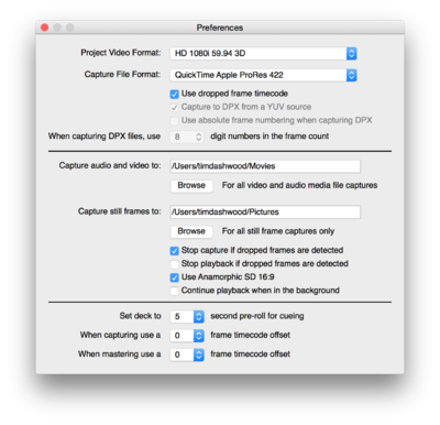

1. Launch Blackmagic-Design Media Express after turning on Ultrastudio 3D
2. Set the preferences to HD 1080i59.94 3D (or whatever format your quicktime are in)

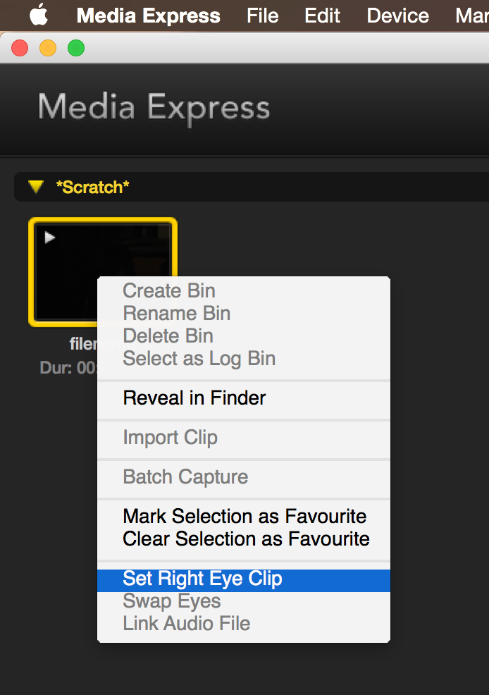

5. Right-click or CTRL-click the clip to reveal the contextual menu.
6. Select "Set Right Eye Clips" and then navigate to and choose the right eye clip.

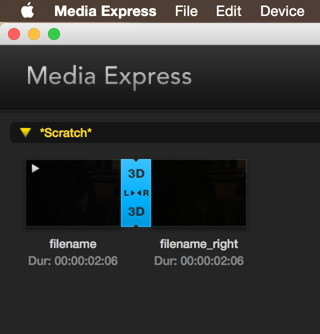

7. You will now have a paired clip that you can play. Save the project for later so you don't have to go through this process each time.
Fooling Ultrastudio 3D-media-express-prefs.png   Fooling Ultrastudio 3D-set-right-eye-clip.png
