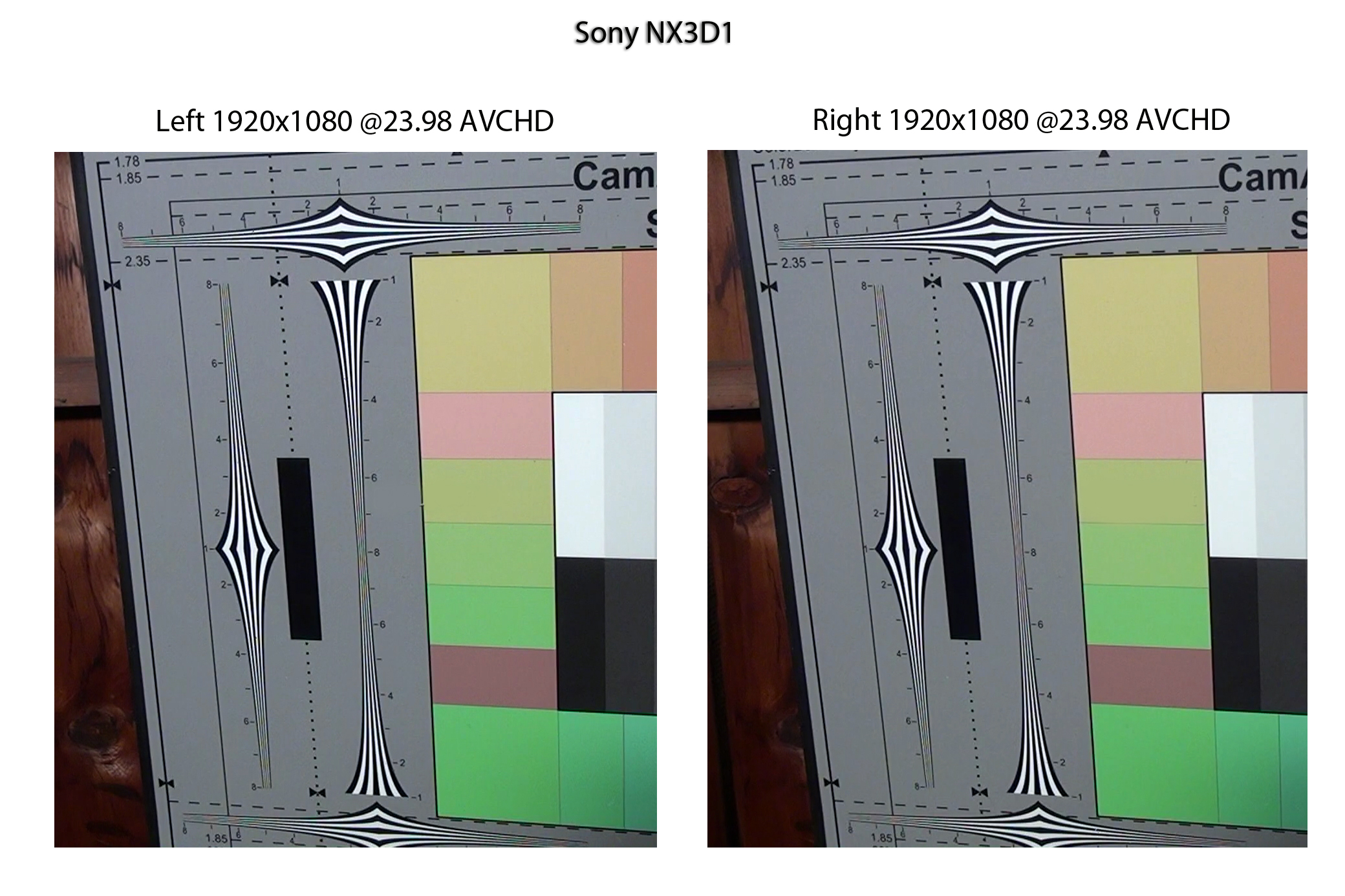

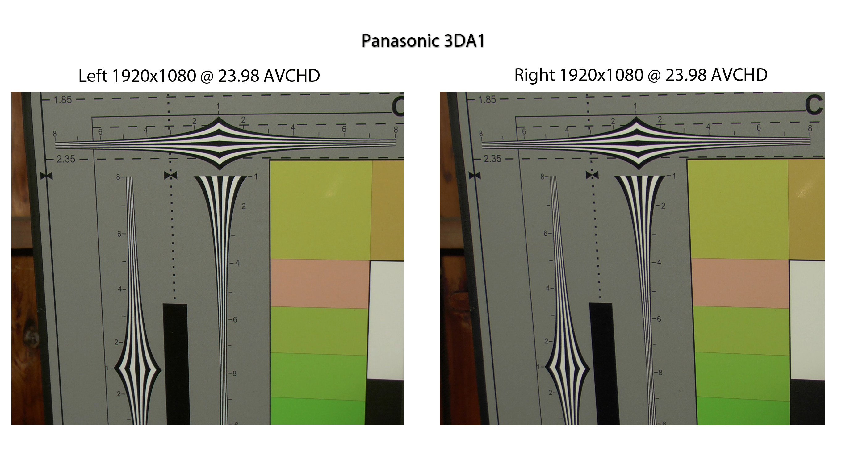

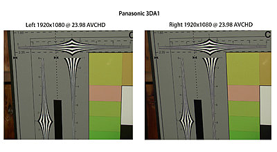

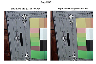

I've done resolution tests of the Sony NX3D1 (list $3000) vs Panasonic 3DA1 (list $21,000)
Viewing the pictures it is clear that the 3DA1 holds resolution up to and over the 800 line area of the DSC trumpets. The NX3D1 starts to crap out at about 640 lines. However on the Sony the differences between the Left full resolution vs Right delta resolution when resolved are insignificant.
Just thought it might be of some interest here.

I think DVINFO may have rescaled your original images. The Sony image is 2080x1386 and the Panasonic image is 2727x1497. What were the sizes of the images you uploaded?

I'm curious about the color difference between the two. Is that an artifact of the test, or are they really that far apart, at the same white balance?

Yes, the discrepancy in picture size is my fault because I zoomed in to each chart to get to the resolution trumpets. I double checked that it was still accurate after the zoom and it was because it was a very slight amount of zoom. On the color balance, they were taken under different circumstances and to be fair, this was a resolution test, not a colorimetric test so I didn't take too much care on the color balance.
