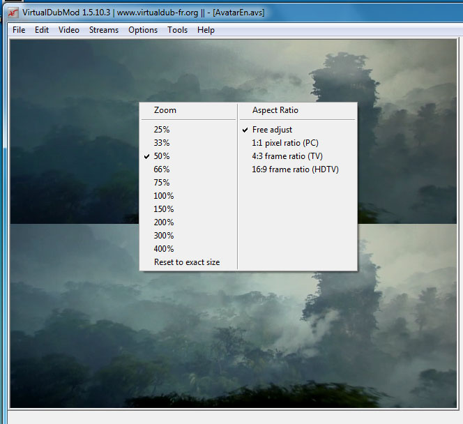

Old February 13th, 2011, 10:24 AM   #37
Join Date: Jul 2010
Location: Central NJ
Posts: 42
VirtualDubMod View
Just right click on the image in VirtualDubMod and set a viewing magnification. See the attached screen grab.
