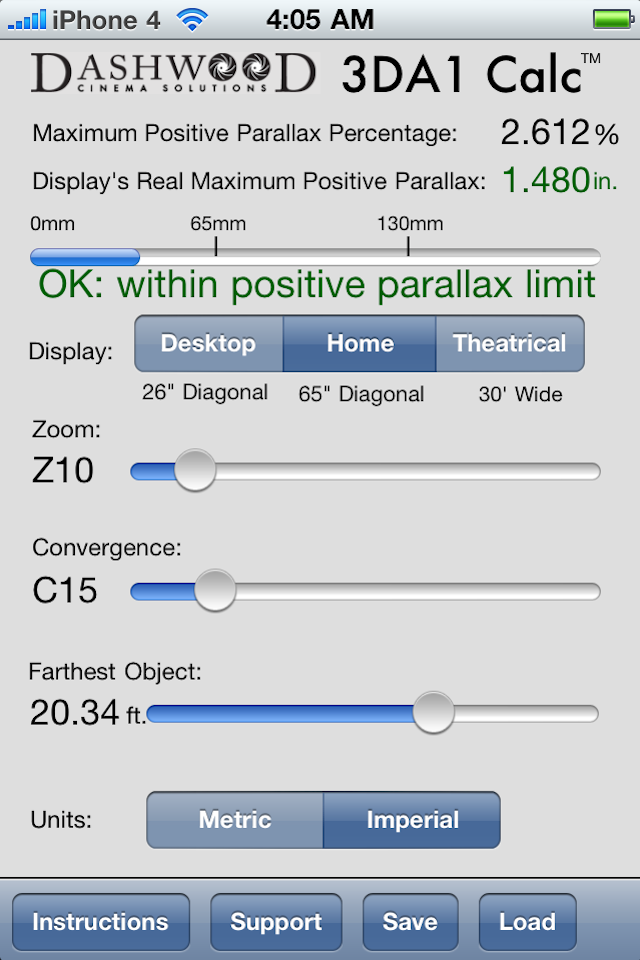

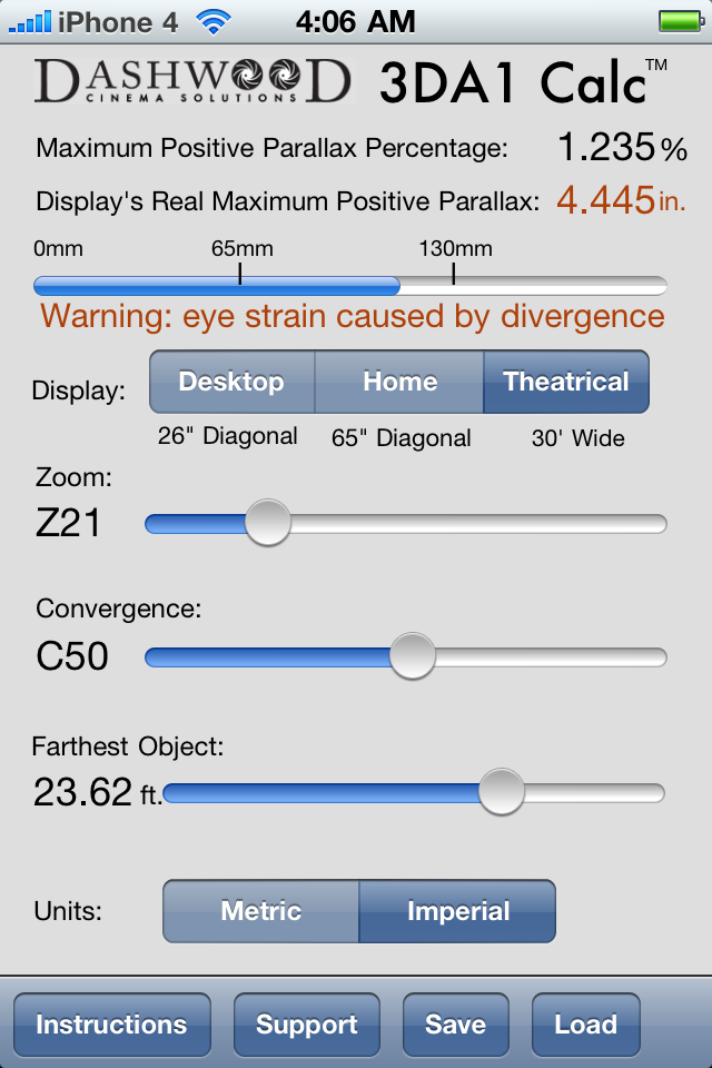

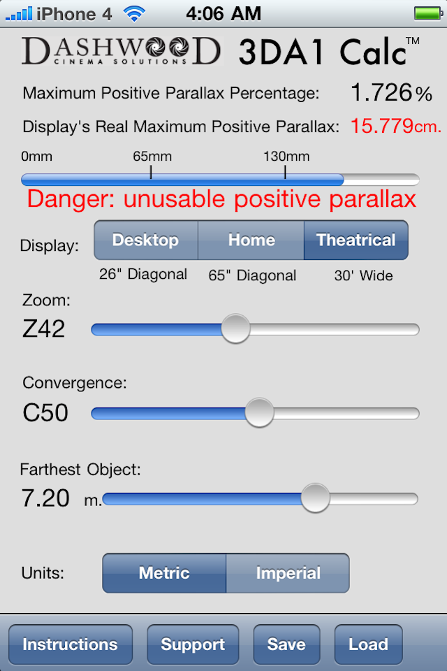

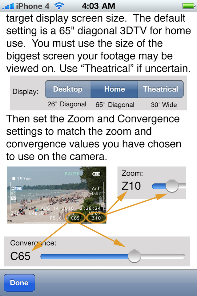

Some of the language gets lost in translation but the "77-type" refers to a 77 inch diagonal TV. This was Panasonic's solution to providing the user with a guide for permissible positive parallax and depth budget at a given zoom and convergence level depending on your eventual display size. Think of it like a depth-of-field chart, but for depth budget. The first setting is for home use and the second setting is for the big screen (30foot wide I assume.) It is a bit counter-intuitive for a shooter though.
My solution was to write an iPhone app. The camera doesn't tell you the actual focal length or convergence distance and instead gives the standard Panasonic 00-99 readout so it is impossible to use any standard stereoscopic calculator with the AG-3DA1.
My app called "3DA1 Calc" is already on the Apple app store. 3DA1 Calc for iPhone and iPod touch on the iTunes App Store
We are not officially announcing it until next week at IBC but seeing as how some people have already received their production units the sooner you have it the sooner you can start making watchable 3D.
We are also releasing our 3DA1 ingest app for Mac OSX next week. We previewed this at NAB but it has been streamlined since then into a nice simple app that can quickly create reference quicktimes in side by side or top and bottom modes for "instant dailies." Those can then be encoded into ProRes422 or whatever you want to work in for Premiere, AE, FCP, etc.
Panasonic AG-3DA1P first impressions-screen-shot-2010-08-14-4.04.50-am.png   Panasonic AG-3DA1P first impressions-screen-shot-2010-08-14-4.03.33-am.png
Panasonic AG-3DA1P first impressions-screen-shot-2010-08-14-4.06.00-am.png   Panasonic AG-3DA1P first impressions-screen-shot-2010-08-14-4.06.30-am.png
