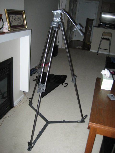

Just got my LS-22 combo with the ZC-3DV remote control from B&H. Since there are not many posts talking about this trip, may be I can share some thought and photos with people who might be interested in this budget combo. This is my first tripod set with a so-called "fluid" head (I know that it is not fluid, but it is "fluid" comparing with the 700RC2 I have).
Attachment 1793
The combo comes with the H22 head, T58 1-stage tripod, SP-1 ground spreader, a TC50 padded bag and ZC-3DV remote control.

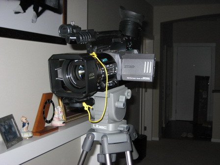

Head Attachment 1794

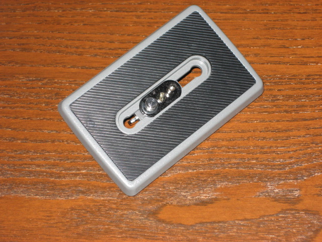

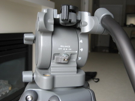

A very solid head. The side shells are made of hard plastic. The mounting and center piece is made of metal. I find the pan and tilt are much smoother than my 700RC2. There is no drag adjustment. With my DVX100A, I can balance it with the neutral balance setting (there are front heavy, neutral and back heavy settings). The head can maintain position if I tilt the camera (not more than +/- 10 degrees) and let my hand go. If I tilt more than 10 degrees and let go, the camera will bounce back slowly as expected. Pan is good as well. However, it does bounce back at the end of the pan. I did not experience any sudden loss of drag. Too bad that it does not come with a slide mounting plate. To adjust the positing of the camera on the quick mount, you need to disengage the QM from the head first. Attachment 1795

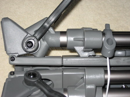

Leg Attachment 1796

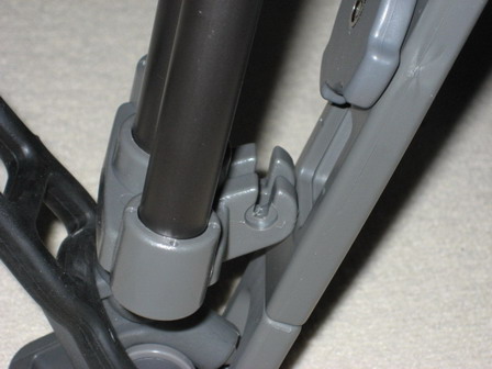

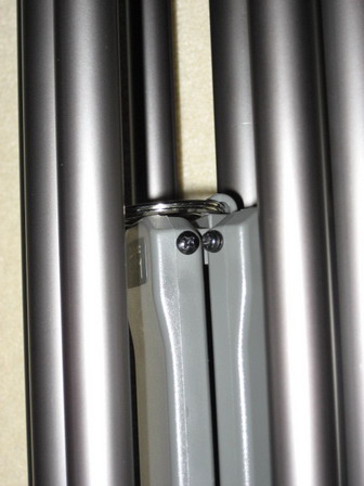

It's single stage. Well built. I don't have a lot to say about the leg. However, I am not happy with the ground spreader. I have never use tripods with a ground spreader. I don't know whether the spreaders with other tripods are the same. However, I can say I hate it. First of all, the SP-1 is made of plastic. I always fear that I might break it when folding and unfolding. Furthermore, the hooks for the mid spreader do not perfectly line up with the slots on the ground spreader. Attachment 1797 You need to extend the legs by 2cm at the final stage of folding. Otherwise, you will break the ground spreader! Attachment 1798 This photo shows how the hook fits inside the slot when they properly line up. This photo shows the construction of the center of the spreaderAttachment 1799. Originally I was going to get the tripod with a mid-spreader for $50 more from Zotz. However, they would't take my Canadian credit card... too bad, my only option was B&H and their combo only comes with the ground spreader.

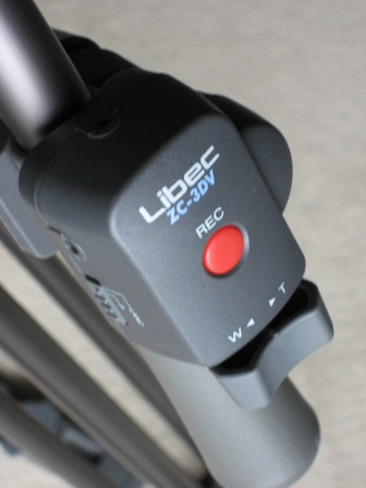

Remote control Attachment 1800
I am very happy with this remote. The rocker is smooth and there are two jacks for the cable. One on the top and another on the side.

As to how the head feels, I love it. Better than the Manfrottos I've tried anyday. Also, it's really, really smooth, and has very little bounceback with a 7-8 pound camera kit on it (just visible at 16x zoom). The counterbalance spring holds my big camera kit at around a plus or minus 10 degree range, but beyond that, the camera will take a slow nosedive. I'm topping out the weight capacity of the head though, so no real qualms there. I'd imagine it's better with a DVX or HVX, or something along those lines. Also, just to clarify, the head is all metal, save for 2 non-load-bearing plastic side pieces, which appear to just be covers. The rest, including the quick release is all grey powdercoated aluminum. I popped a Manfrotto sliding quick release on it and my Steadicam for quick transfers and balancing.
The legs are ultra-sturdy for me, and have had no problems, other than being a little light. (I just stand on the spreader, and I'm fine.) For me, this ground spreader is just like every other single ground spreader I've used, even on the big ol' Vinten I was carrying around as a loaner before I ordered this thing. I haven't had any problems with anything not lining up. My spreader works just as it should. About the non-fitting spreader, the mid-level clips don't match up on mine either, but there have been no adverse effects of not doing the "lower 2 cm" routine, I hadn't even noticed it until I looked for it on a shoot today after seeing your problems. Oh, and one other feature. On this tripod, I found that it had the same spring-loaded cord leg locking system that I had used on a Vinten. Very nice touch over the much more simple clips that are on other tripods. I personally have been using ground-level spreaders for a while though, and this one was a quite good one.
The LANC remote works perfectly in it's "Panasonic" setting with the DVC60. No problems there. I taped the cord in a spiral around the handle so that it's the right length for just reaching up to my camera, so that alleviates the problem of having 3 feet of cord dangling around.
Tom, I've had a look at this (MN357). I'm thinking of getting one, but details are scarce (and there's no shops I can visit in this part of Ireland). Does this just mount onto the Libec quick release plate using the standard screw? It would be very useful to be able to balance more easily, especially when the camera is fully loaded with mic, Lanc controller and battery.
Tom Wills February 3rd, 2007 09:33 PM
Yep, the sliding quick release has 1/4"x20 and 3/8"x16 holes on the bottom. You just use the 1/4"x20 screw from the Libec plate to line it up.

Just in case anyone's intersted, I took delivery of the Bogen/Manfrotto MN357 universal sliding plate yesterday and mounted it on the '22.
Sweeeet! With the VX2100 fully loaded (big battery, stereo mic, Lanc control, LCD sun-shade) it balances absolutely *beautifully*. The sliding plate cost me about £30 ($50-60ish) and makes mounting the cam and balancing so much easier.
I can balance perfectly at most angles. If I complete the pan or tilt and then remove my hand from the pan bar, the camera staus where it is without moving at all, and without having to lock off (though I would still do that if I was going to walk off and do something else). Absolutely brilliant considering the complete price.
