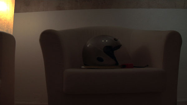

It appears that the EX is a noticeable step up from the 1/3" HVX200 cam with low light.
HVX200:
GAIN 0 dB
Lens set for equal frame composition as XDCAM EX.
Aperture: Wide open
http://www.slashcam.de/images/texte/...-HVX200Low.jpg
XDCAM EX:
GAIN 0 dB
Lens set for equal frame composition as HVX200.
Aperture: Wide open
http://www.slashcam.de/images/texte/...Sony-LowEx.jpg

Wow - both shot 24p 1/48th shutter? What iris?

It came from the German test link on the HVX200 vs EX thread.
The only reference I can see was the frame composition and gain.
That's a good question regarding frame rate and shutter speed.
It may be in there ,but I can't read german.
Having said that, I would believe they were set up the same.

In all honesty, and with personal experience with the HVX, I HIGHLY doubt this comparison. Something's just not right about it.
The HVX is about a stop shorter than a DVX100a.
With a lamp shot like this, I truly doubt that the HVX would have THIS MUCH trouble getting a decent image..
I don't know. All I say is, don't count your chickens just yet. Wait until a decent comparison is done.
Steven Thomas October 9th, 2007 09:38 AM
I hear you; though I can't imagine why this test would of been fudged.
It's not hard to do.
Set up both cams for the same frame composition.
Set bot cams to the same frame and shutter rate.
Set both to 0 dB gain.
Open the apertures on both and watch the show..
Now having said that, 0dB gain is a relative measurement within each cam.
Now, if the test was done correctly, what would the HVX200 look like with +3 to +6dB gain. If it produces the same luminosity and has the same amount on noise, then that's a different story. On the otherhand, by cranking the gain to +3 or +6 on the HVX200 and it matches luminosity of the EX, but the image is noisy.. Well, you know where I'm going.
You make a good point thought. We will have to wait and see. Although, we are hearing it fairs well in low light ( 1/2"), so I would not be surprised that it's better than the HVX200.

The actual gain factor must have played a dominant role in the output of this comparison - with the EX1 scale starting with the "negative" gain of -3dB, its 0dB does not necessarily correspond to that of other cameras.
Steven Thomas October 9th, 2007 10:22 AM
Good point Piotr.
I forgot that the EX offered -3dB.
But, if its 0dB reference is free of noise, I see why it maybe labeled as such.
Unless one designed the gain circuit in the cam, It' hard to know how the gain is configured and referenced.

This is true but we are talking about different chip sizes so its simple physics that its going to be considerably better in low light.
Piotr Wozniacki October 9th, 2007 11:43 AM
Daniel, I never suggested it isn't - but in practical terms, I don't think the difference is as big as the pictures suggest.
Also you must remember that each individual pixel is of a much smaller size on the EX1 than on the HVX, because of its number.

At -3dB gain the EX1 provides correct exposure rated at 800ASA. Shots of a model exposed at +/- 2 stops corrected well, without noise being visible in the 2 stops under material I saw projected (unfortunately using a data projector). 2 stops over and the high lights were burned, but the soft graduation looked natural. Don't know the gamma curve selected. Was impressed by images in a poorly lit auditorium (at -3dB) where the Z1 would have needed 18dB. This was a default gamma and looked even better when I dialed in black stretch. I didn't have time to try out other cinegamma curves.

But, the surface area gained by going to 1/2 inch chips does not seem intuitively to explain these kind of impressive results...
To me, these results seem to defy physics...
Again I hope it's true, but I'm a little skeptical...

Adam Reuter October 15th, 2007 03:49 PM
Looks Accurate for the HVX200
I'd hate to break it to some of you HVX200 lovers out there but the camera IS NOT GOOD in low light. The frame grabs in the first post look very similar to tests I've done using 0 dB, 1/60, 1080/60i settings on the HVX200. While I love the Panasonic in every way, it requires a decent amount of light to look good. Anything over 6 dB of gain on that camera looks like garbage in HD. 1/3 inch chips just can't cut it at the moment for HD acquisition in low light.
The setup for the photo looks like a living room with no couch lighting. The only lighting is from that lamp and it's not pointed at the couch. If the Sony camera can do that good with little to no noise it will be a stellar camera. The Digital Content Producer magazine preview mentioned that it's a tad faster than the PDW-F330/F350 cameras in low light. Sensitivity of F10 at 2000 lux, whereas the PDW-F330/F350 are F11 at 2000 lux.
On a side note, I really hate how tests are conducted on independent sites. Those two pictures aren't worth the bandwidth used at 600pixels wide. Where are the full raster 1920x1080 pictures at? And then you have screen grabs that will be released when the camera comes out that people color corrected. BOO! Raw data please at practical settings. 24p at 1/24 shutter speed does not count (people were using this to show HVX200 sensitivity pics).
Let's use BitTorrent to host the jpeg files (or PNG files) if bandwidth limits are a concern!
If this camera lives up to the hype, Panasonic is making a huge mistake by not updating their chip for the next iteration of the HVX200. Or for that matter, not upgrading their LCD screen to HD.
