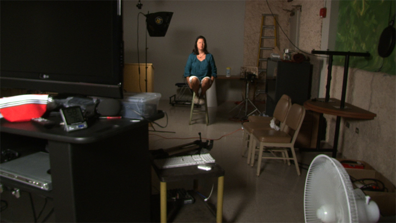

Ed Quinto November 9th, 2009 01:23 PM
2 Attachment(s)
V1 max wide. 20ft from subject 250w on subject, 500w filling the foreground. 0db gain 1.6.
Attachment 14909
z5 max wide. 20ft from subject 250w on subject, 500w filling the foreground. 0db gain 1.6.
Attachment 14910
Jeff Harper November 9th, 2009 01:34 PM
That is dramatic...
