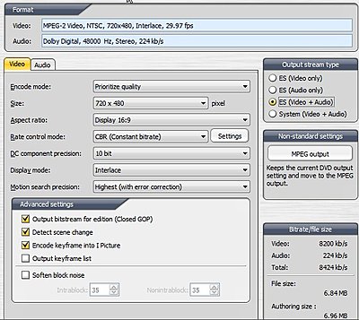

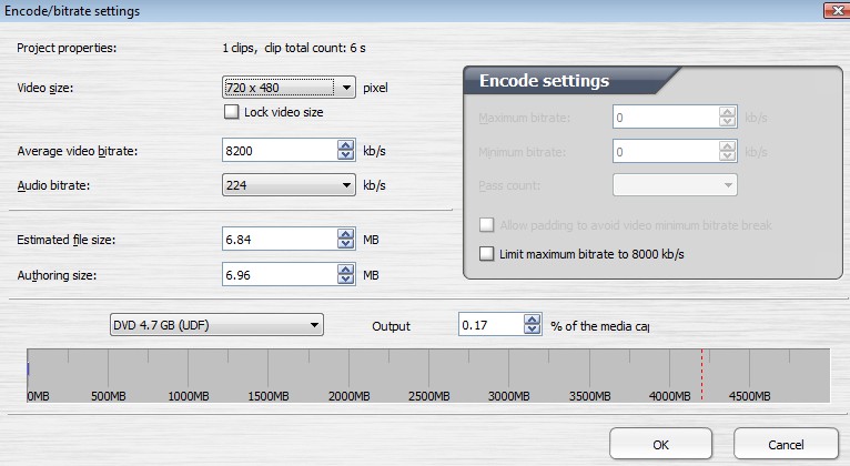

Tariq,
I don't work with FCP since I am on a PC but I do have a lot of experience with DVDs both replicated and duplicated. After going thru several months a while back experimenting with the best encode from HD to SD for DVDs I arrived at an acceptable solution. I export a lossless file from the timeline and encode with TMPgne4 (now Video Mastering Works 5). I encode to mpeg2 using pretty much the standard settings and get excellent results. I have included a screen shot of my settings. These are the settings that I use for replicated discs. For duplicated discs I lower the video bitrate to around 7600. A fully functional trial of VMW5 is available if you wish to try it.
DVD Quality-screenhunter_76-feb.-01-10.28.jpg   DVD Quality-screenhunter_77-feb.-01-10.29.jpg
