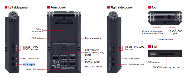

Hi Greg!!! Thanks again for all of your help. :)
Originally Posted by Greg Miller (Post 1619602)
First of all, which input to use. As I recall, the spec sheet for those mics & battery box say you should connect them to the line input, rather than the mic input. The line input is designed to accept much higher audio voltage from the mics.
Doh! You know, now that you mention it... I think I have been using the mic input rather than the line input. :(
From the manual:
Attachment 21583
Audio Inputs
Internal Stereo Microphone, Mic input (Stereo miniature phone type, plug-in powered mic), Line input (Stereo miniature phone type)
*The Internal/External Mic and the Line input can't be used at the same time; only the Line input is effective.
I can't believe I did not realize that it was best to use the line input. To be truthfully honest, I did not even realize that there was a line input. I always just plugged my mics into the mic input and called it good... Sheesh, I can't believe I did not think about using line input when using the battery pack. :(
Looking back at our conversations here, it looks like you point this out at least a couple times and I never put two and two together. For example:
