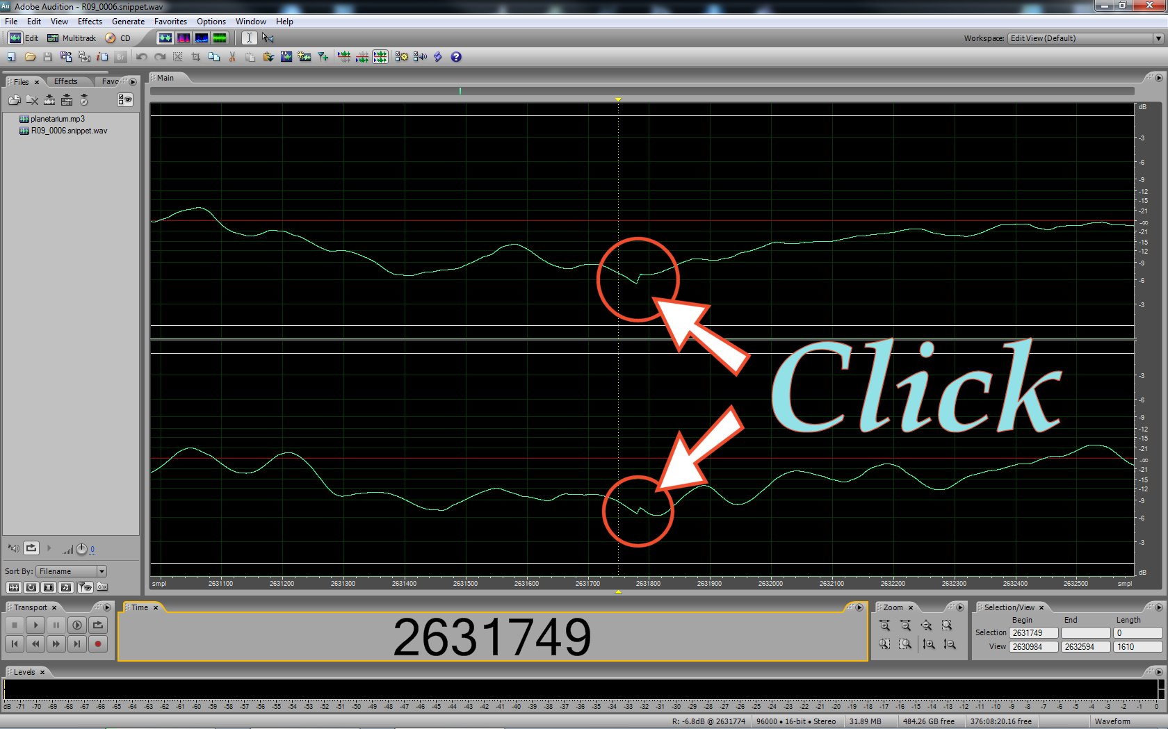

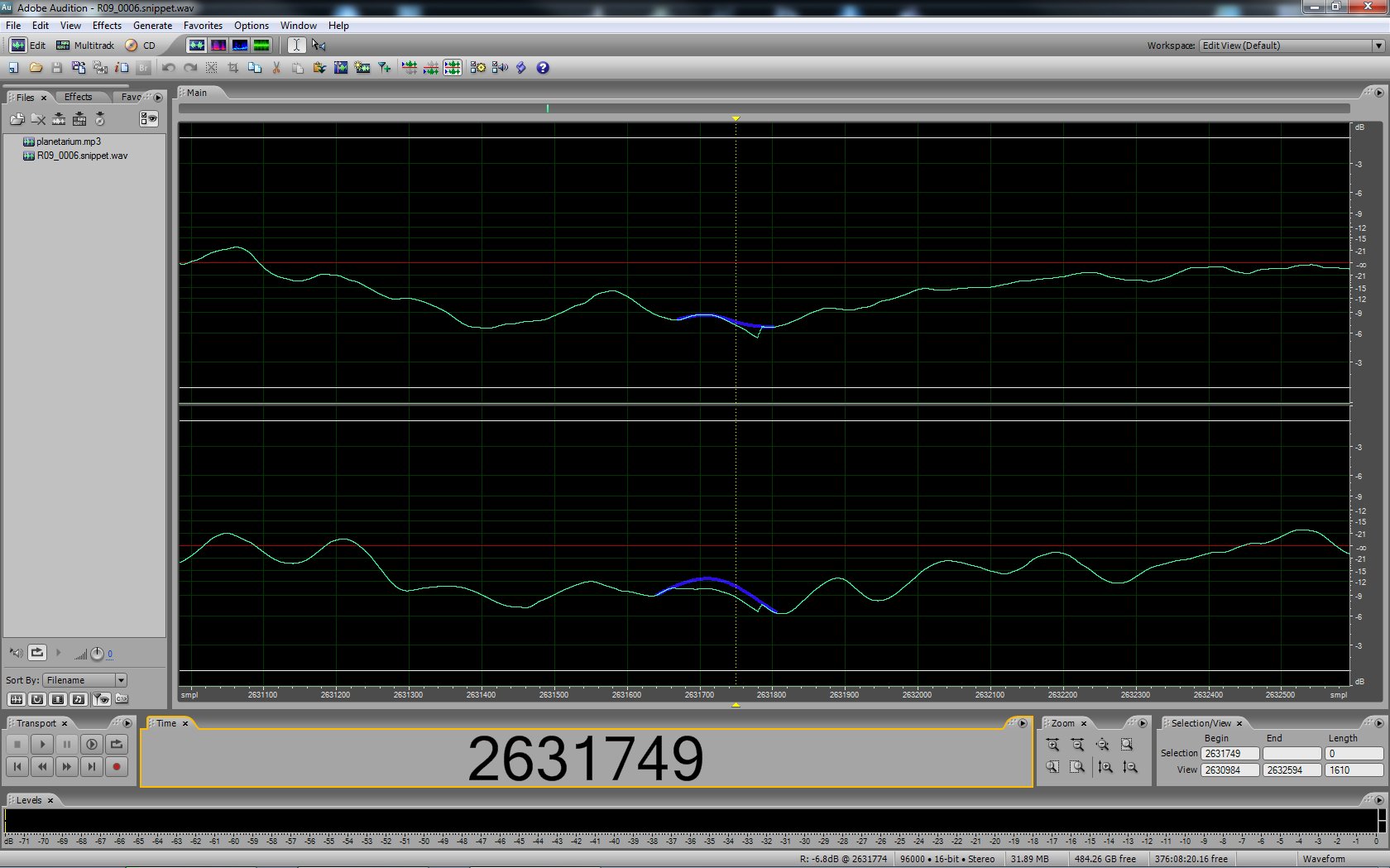

Robert Wiejak February 6th, 2011 04:37 PM
2 Attachment(s)
Gentleman,
I will admit that I have not read the whole post, but I listen to your sample and found your ‘clicks’.
To me it looks like hardware, maybe power supply problem.
Take a look at the first picture and see where the click is in that waveform.
Attachment 21381
Then look at the second one and see if you agree that the waveform should look like the blue line in the second picture.
Attachment 21382
The whole ‘signal rise’ (the correction) in the first picture (the top waveform) is only over 7 samples @ 96Ksps, hence the click.
The difference over these 7 samples is 68dB.
I don’t have a solution for you, just thought I’ll share my findings. Interesting problem.

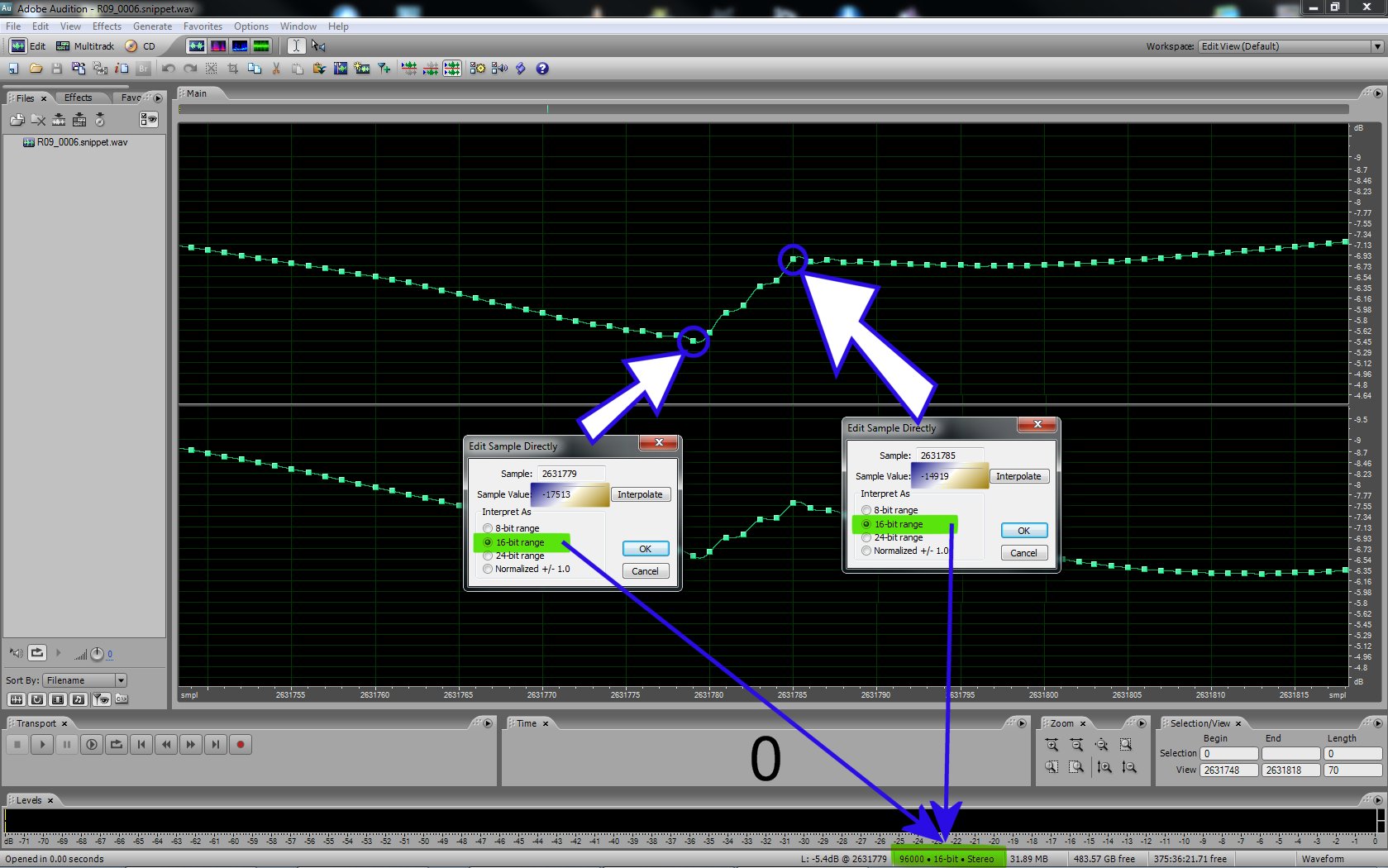

Robert Wiejak February 6th, 2011 09:37 PM
1 Attachment(s)
Originally Posted by Greg Miller (Post 1615326)
I think you're way off. For example, in one "click" I analyzed, the "pre-click" sample value was 3959127, the "post-click" sample value was 3337707. Dividing those numbers gives a result of 0.843, which corresponds to a change of -1.48dB. If you expand whatever waveform display you're looking at, the vertical (amplitude) scale of the display will confirm that.
Attachment 21384
Funny thing about dB's, they are very misunderstood creatures.
dB is a ratios of two (one known, the other measured) quantities expressed in logarithmic units.
If you ware referring to full scale (the known value), compared to distorted samples (pre-click & post-click = measured value) then you are absolutely right, the difference is less than 1.5dBFS.
But I didn’t say full scale, I said ‘…the difference over these 7 samples…’ implying same as you pre-click & post-click:
-14919 - -17513 = 2594
Then to get the voltage ratio of the difference: 20 * log(2594) = 68.28dB
I hope this explains how I arrived at that number.
Remember, dB’s are not absolute numbers, they are always in reference to something.
Your numbers are in reference to full scale, my numbers are in reference to each other (pre-click vs. post-click).
Both results are correct.
Greg Miller February 7th, 2011 04:04 AM
Sorry, no, both results can't be correct, because 68 does not equal 1.5.
Funny thing is, I've been using dBs for 40 years, both in terms of circuit voltages, sample values, and in terms of antenna power. And I do understand the proper way to use dB.
When comparing two signals, you either divide the arithmetic sample values, or you subtract the dB values. The two operations, dividing the arithmetic values, or subtracting the dB values, are mathematically equivalent.
You're getting confused because you subtracted the two sample values, rather than dividing them to get their ratio.
As you correctly state,
dB is a ratios of two --<snip>-- quantities expressed in logarithmic units
dB always represents a ratio, which is then converted to a logarithmic scale.
Since your goal is to express how the second sample is related to the first sample, and express this relationship in dB, you need to start out with the ratio of the sample values. To get the ratio, you divide the two values. (Your mistake was that you did not find the ratio between the two values, because you did not divide them... you erroneously subtracted them. Subtracting does not give you a ratio.)
Then, as you state, you convert that ratio to a log, and multiply that log times 20.
The arithmetic sample values are absolute values. 3,959,127 and 3,337,707 are the actual value of those samples (converted from the binary data stored in the file). Full scale doesn't matter. Full scale could be any number bigger than 3,959,127. (Of course the actual value of "full scale" depends on the bit depth of the samples.) Regardless of what full scale is, those sample values are what they are.
In this case, to find the ratio of the two samples, you divide the second value by the first value, and you find that the second value is 84.3% of the first number. The log of 0.843 is -0.074. Multiply that by 20, and the result is -1.48dB. Therefore, the second sample is -1.48 lower than the first sample.
Don't take my word for it. (Apparently you do not.) You probably don't have the same books that I have in my reference library, so let's go to a readily available source: Wikipedia. Look up "decibel." Scroll down to the section titled "Field Intensities." (Note that the dB originally was used to measure power ratios, where the formula is 10*log(base10) of P1/P0.) Voltage, or in this case digital samples, is not a measure of power, it's a measure of intensity. So in this case the formula is 20*log(base10) of A1/A0.
Again, you did not divide A1/A0, you subtracted A1-A0. That does not conform to the correct formula, as shown above (from Wikipedia).
Let's look at it graphically. We'll use the file you posted. The "pre-click" sample you have circled is at -5.45dB on your software's scale. The "post-click" sample you have circled is at roughly -6.8dB. The second sample is about 1.35dB softer than the first sample. Incidentally, that's fairly close to the two samples that I analyzed... quite close, considering we analyzed two different samples at two different points in the file. In fact, the distortion mechanism here is quite consistent from one click to the next.
Another way to think about this: If our two "click" samples were 68dB different, that wouldn't be just a little glitch on the graph, it would be a huge jump. If the first sample was -5.45dB, the second sample would be -73.45dB. That wouldn't be just a slightly audible click, that would be a huge speaker excursion!
Look at it mathematically, look at it graphically to confirm it. Either way, the two samples differ by roughly 1.5dB, and that is not the same as 68dB. -68 is an entirely spurious number.
Ugh, I would hate for it to be hardware related. :(
I can't really afford to re-buy a recorder and/or binaural mics.
Do you think it could be the battery pack?
In the last tests I did at home I did not experience any cracks/pops, but then again the bass was not as deep, although I did have my head right up next to the speaker (and it was turned up loud... My wife kinda got pissed at me that day). :D
