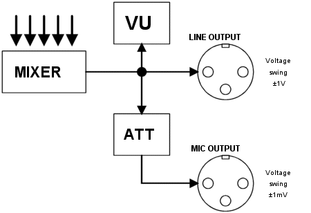

Robert Wiejak October 11th, 2010 02:48 PM
1 Attachment(s)
Originally Posted by Marc Hlavaty (Post 1577434)
1. If I attach attenuators to the XLR output cables from my mixer, the mixer's VU meters see that and drop to around -3 volume units (70%). The more I attach (like the H4n recorder, the more this happens). This ONLY happens when the mixer's output is set to LINE, not MIC. When set to MIC, no drop on the VU meters. Is this something that happens on other mixers, say Sound Design, and is considered a normal thing on any mixer?
I am confused about your choice of words: Are you using attenuators or splitters?
What do you mean: “…The more I attach … the more this happens…”?
To answer the rest of your questions: You only see it when attached to line level output, because the VU meter only monitors the line level output. The microphone output is the same output but after properly matched attenuation. In other words, if you load/short the line level output your VU meter will show signal drop, if you load/short the microphone output the VU meter will never see any voltage drop, because that output only swings mVs at most not enough to register on the VU meter.
Attachment 19821
2. Whether on not it is a normal occurance for any mixer, do I need to compensate by "upping" the mixer's Master Level so that the VU's volume units register at 0 again, or do I ignore it and set the recorder's level as I normally would?
The answer to your second question is: Yes. Your VU meter is measuring the voltage across the load you have attached to it. So if you are overloading the output, the voltage will drop. Not enough signal is at the input of the next stage, therefore need to compensate/adjust. Despite what other say (inferior design), the fact that the mixer is measuring its output (not just internal mix bus), it showed you the problem with the way you have connected the components. In my opinion: a great (unexpected) diagnostic tool. On the other hand, if your mixer was monitoring just the internal mix bus, you would be convinced you are sending 0VU, but at the other end of the cable you would never see the levels you were expecting (…probably wandering why). In a studio setup a technician when connecting everything, will make sure all inputs are provided proper levels using adjustable DAs, so monitoring mixer’s internal mix bus is enough. But in situations where configurations can change each time you go out, the way Azden is monitoring the line level output is to your advantage.
