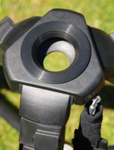

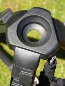

  • Vinten 75 mm Ball to 100 mm Bowl Adapter
The last item was to allow my 75 mm Vision 3 head to be used with the 100 mm bowl FiberTecs, and does not really need a mini review in its own right. The only notable things about it are that its design is quite different from two other adapters I already owned, and it fits better with the FiberTec receiver. I strongly recommend it if you do purchase a Vinten tripod of any sort and require such an adapter.
Left: without the 75mm-100mm bowl adapter; Right: with.Left: without the 75mm-100mm bowl adapter; Right: with.
