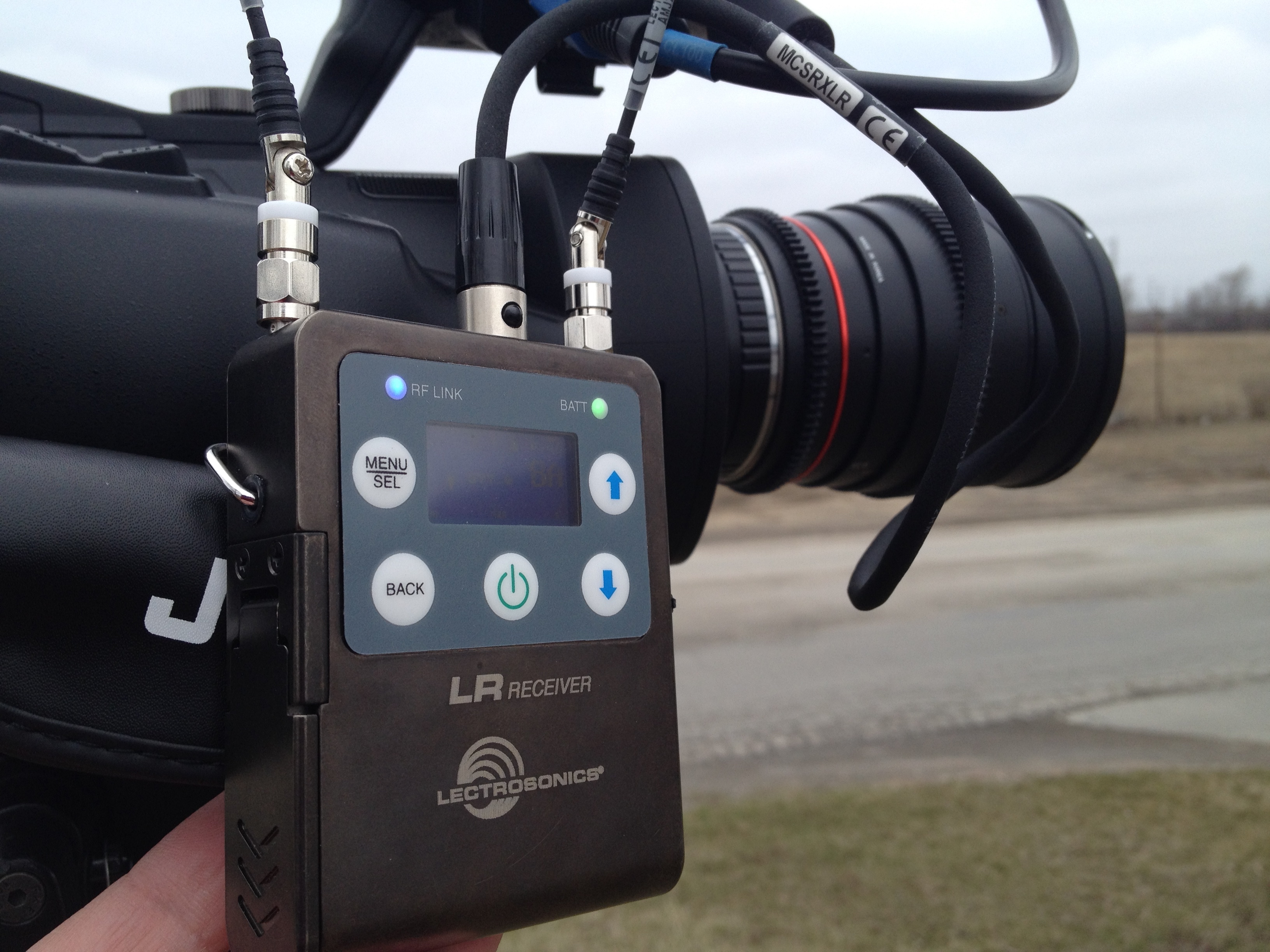

The first thing you will notice when handling the Lectrosonics L-Series transmitter (LT) and receiver (LR) is that they are built for a war zone. There are no flimsy plastic doors on these units. It looks like they are solid aluminium and built for heavy field use.
The front panel of each unit has five clearly labeled push buttons that let you adjust every control in the menu. The plugs for the microphone and the XLR or 1/8” output cords are multi-pin clip-in style.

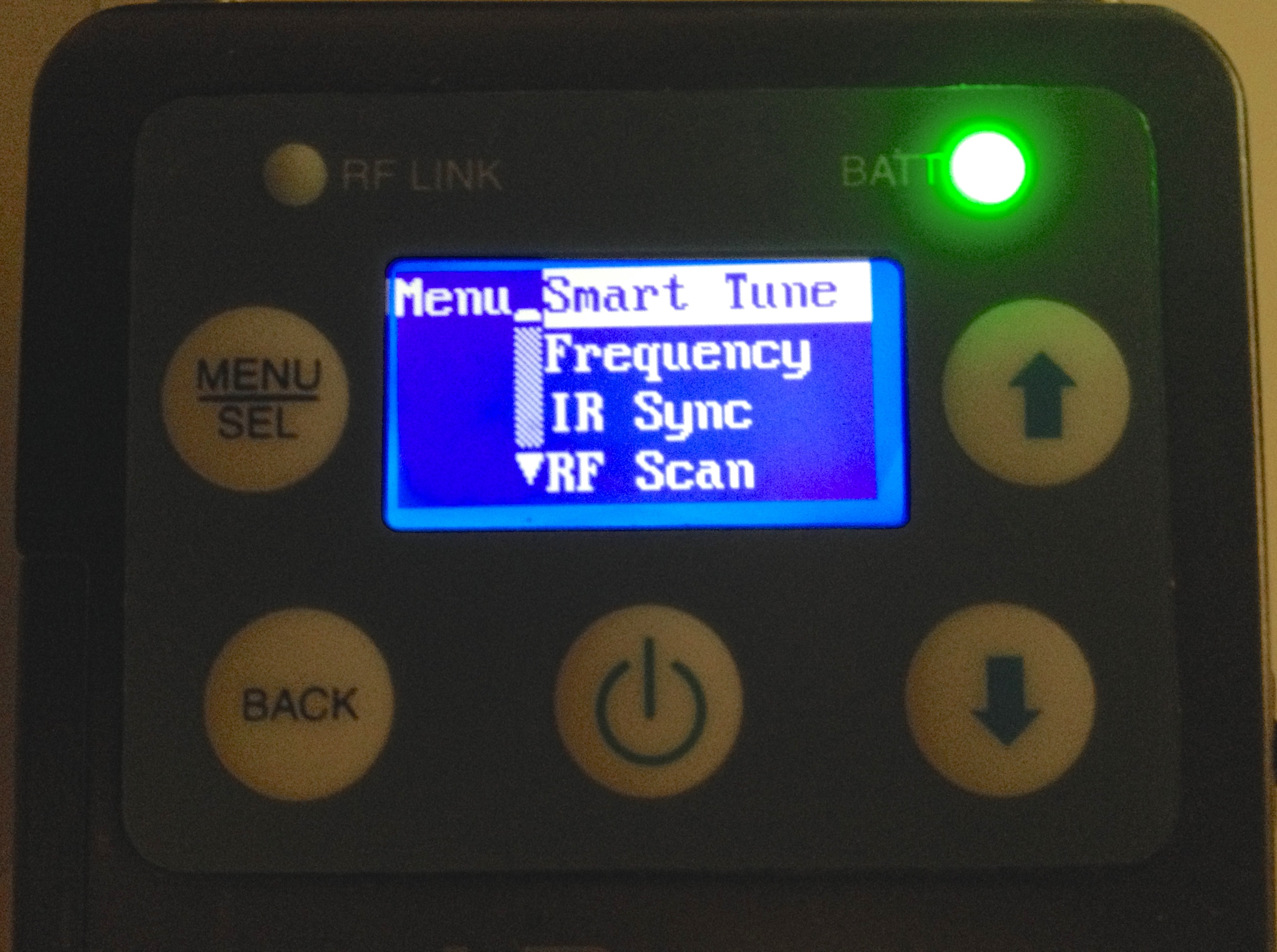

The menus in both transmitter and receiver units are very intuitive and easy to figure out without reading the manual. The most notable feature of the L-Series receiver is “SmartTune.” It can scan the whole frequency range and automatically select the ideal frequency to use. Not only will this save time, it is also fun to watch. When the scan is complete and a frequency automatically selected, you can then simply point the receiver at the transmitter and automatically sync the two units to each other via infared (IR) transmission. I loved how simple this was. I can imagine this feature alone would save loads of time in the field when you have multiple wireless units using various frequencies.
Scanning all available frequencies
A clear frequency automatically selected and ready to sync with transmitter
Transmitter and receiver now on same frequency

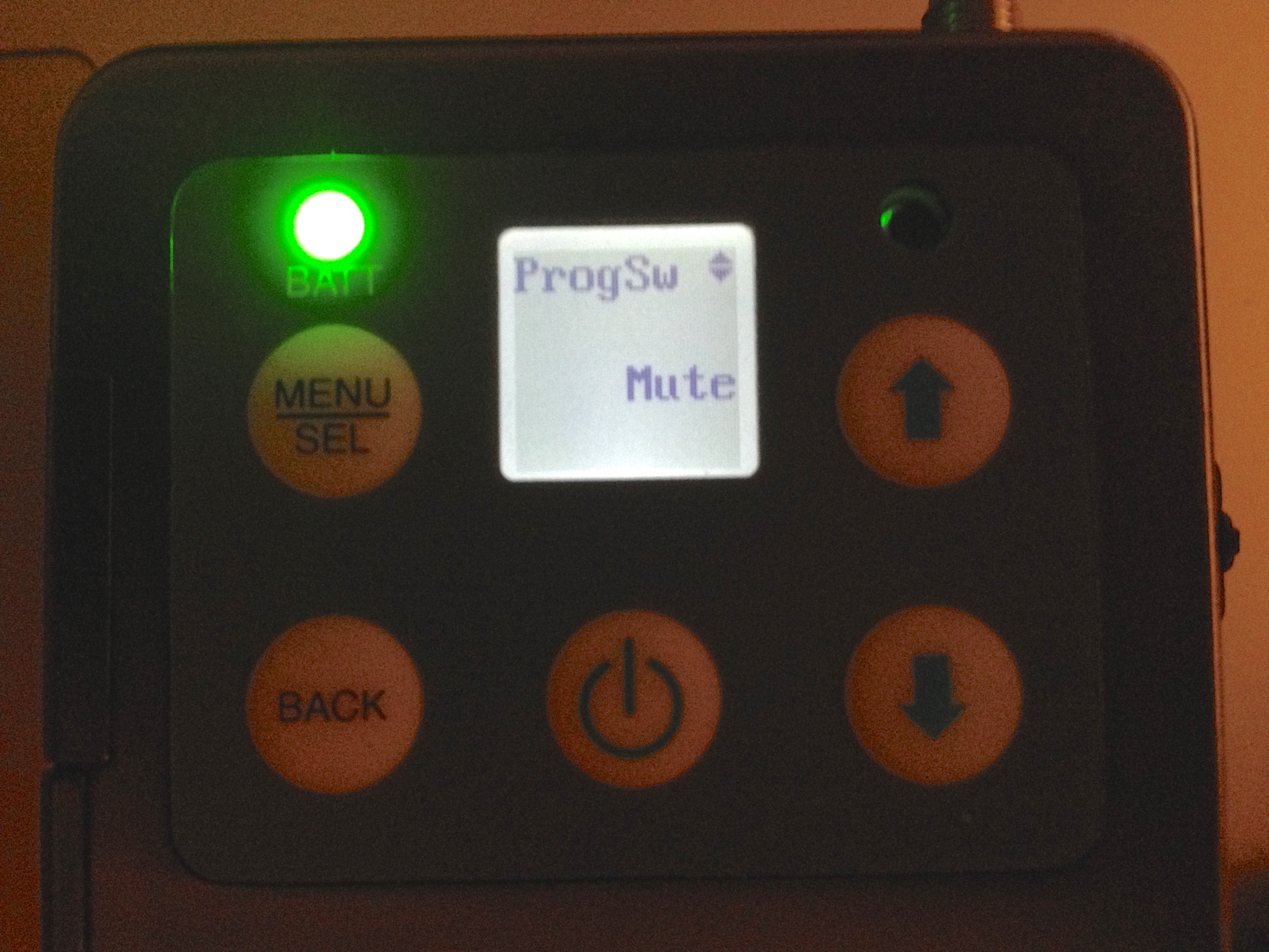

The other feature worth mentioning is the switch on the top of the transmitter. It can be assigned in the menu to be a mute switch, power switch, talkback switch, or disabled completely. I set it to mute so the wearer can simply flip the switch when they need some privacy.

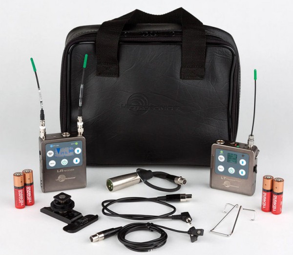

A complete kit with LR receiver, LT transmitter, hotshoe mount, 1/8” patch cord, XLR patch cord, lav mic and zippered carrying case can be ordered for under $2500 USD.
