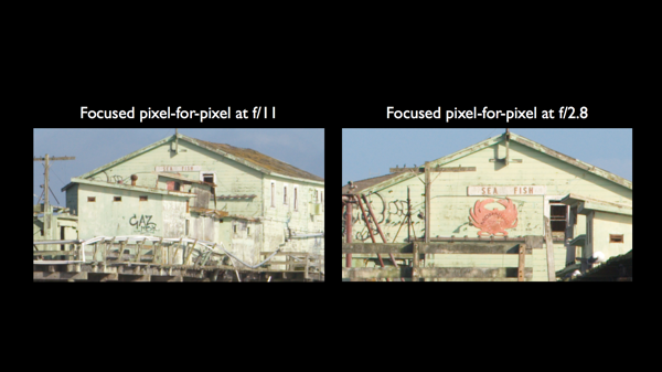

I captured the shot on the left after ignoring Adam’s advice to always open up the f-stop on the lens before focusing. I did this because opening up the stop on an FS700 is a pain when using still lenses as you have to crank in a ton of ND and then spin, spin, spin the aperture wheel to bring exposure back to the point where you can see something to focus on. This takes 10-20 seconds per shot, and sometimes I just want to get the shot and move on–or grab a shot before it goes away. I learned the hard way, though, that this is a shortcut you can’t take with the FS700.
The shot on the right was taken using Adam’s method (which is the correct method):
CIneGear 2013 Art v4a 004
What may be hard to see at this resolution is that the shot on the left, that I focused by eye at f/11 against Adam’s advice, is slightly soft. It’s too soft to use in 4K, where the goal is to make everything really sharp to take advantage of the extra resolution. The focus is only slightly out, but it’s really noticeable in 4K. The picture on the right was focused at f/2.8 and in 4K it’s tack sharp.

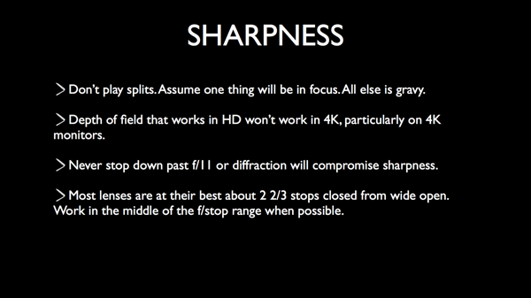

In 4K you really need to make sure something is in sharp focus at all times or the image will look soft overall. Focus splits under such circumstances make me very nervous. If the most important thing is in focus then it’s no big deal to try to hold other things in focus as well, but at least you’re safe if your focus split fails. It’s best to pick a single point of focus and make sure it is sharp.

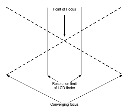

The diagram above shows focus converging on a single point of focus (dotted lines) and the limits of the on-board LCD finder resolution. Notice how the the depth of field outside the LCD resolution limits converges gently, not dramatically. This is what happens when you focus with a lot of depth of field (say, at f/11).

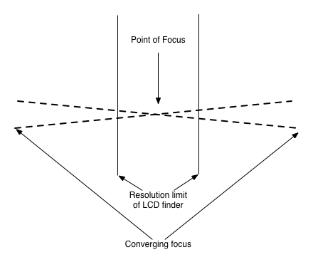

This diagram shows you what happens when you open up the stop (to, say, f/2.8). Focus converges much more dramatically, so even if you still have some slop within the resolution limits of the on-board LCD you can still see focus as it “snaps” in. At f/11 it’s easy to roll focus around and not see much of a difference in the on-board LCD, but you’ll see a huge difference when you watch the shot in 4K. At f2.8 you’ll see definitely see the point of focus much more cleanly. I never lost a shot opening up the lens all the way to focus.

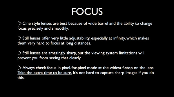

Point by point:
  • Still lenses have small barrels with focus markings that are approximate only. This makes it impossible for a camera assistant to focus by the numbers. Cine lenses have bigger barrels and very precise markings so that an assistant can find 9’10” very, very quickly.
  • Still lenses are not designed for manual focus. The difference between focus at infinity and focus just in front of or past infinity is approximately 1/2 of a gnat sneeze. Unless you have several gnats and handful of pollen it’s going to take a long time to dial in, with shaky hands, the exact point on a still lens where infinity is in focus.
  • Still lenses are very sharp. You’ll never see that sharpness when shooting in the field.
  • As well as opening up to the widest f/stop for focusing, use pixel-for-pixel magnification mode as well. If you do this your images will be sharp. If you don’t do this they most likely won’t be.

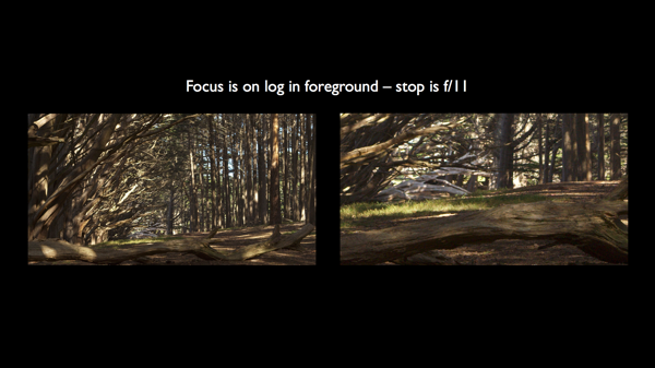

Here’s an example of what happened when I tried to play a focus split:
CIneGear 2013 Art v4a 009
It’s hard to tell in this small an image, but what I’m trying to show is that the log is the ONLY thing in focus. (Everything looks sharp on the left, but on the right the background is noticeably soft. When projected in 4K the background of the lefthand picture looks soft as well.) Splits work in HD, but not in 4K.

The point of shooting in 4K is to take advantage of the extra resolution, so it makes sense to use sharp lenses set to an f/stop that falls within their sharpest range (usually f/4-f/11).
