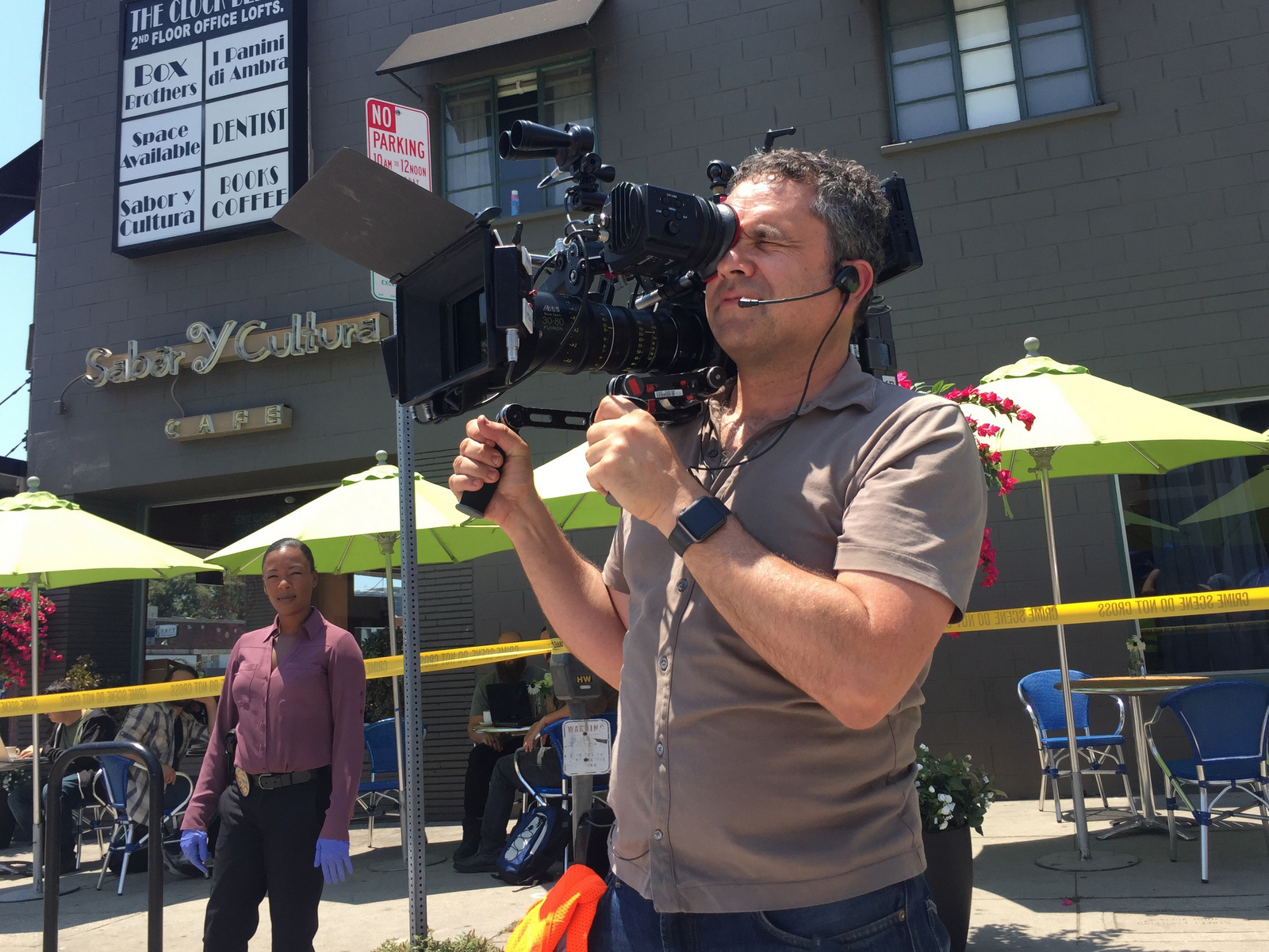

The VariCam LT builds – rented out of The Camera Division – were essentially long and low to keep the cameras balanced for handheld shooting. Papert’s primary lens was a Fujinon 19-90mm Cabrio zoom, as well as ARRI Alura Lightweight zooms. “In an ultra-fast paced TV schedule, I find it very difficult not to have the flexibility of zooms,” explains Papert. “We would sometimes zoom within a shot, as well as reframe a shot for the director at given moments to get a tighter piece of coverage for certain lines.”
Although he doesn’t normally shoot wide open, Papert reveals that he usually shot at T2.9 and a third. “The funny thing is in recent years, you typically wanted to stay away from the ends of the lens to get maximum clarity,” he reveals. “But with modern lenses so sharp, I think it’s actually a benefit to get them perform a little worse to match what many others are doing with vintage lenses. With the LT, or any of the VariCam’s, if I need an extra stop, I can always tune that in with the ISOs.”
