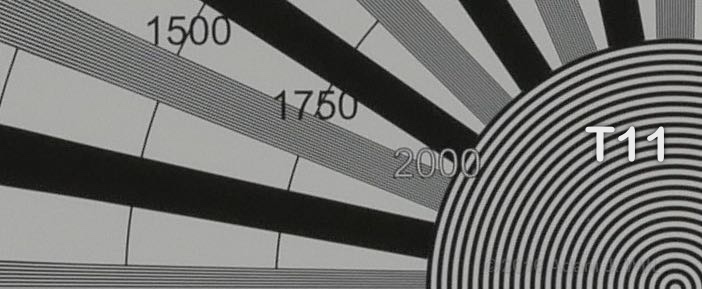

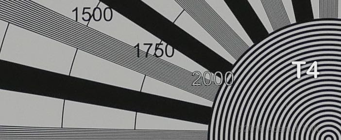

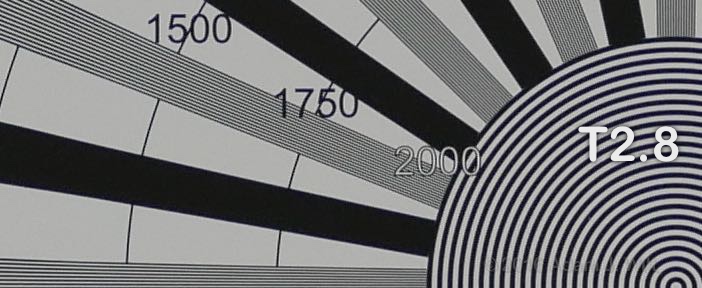

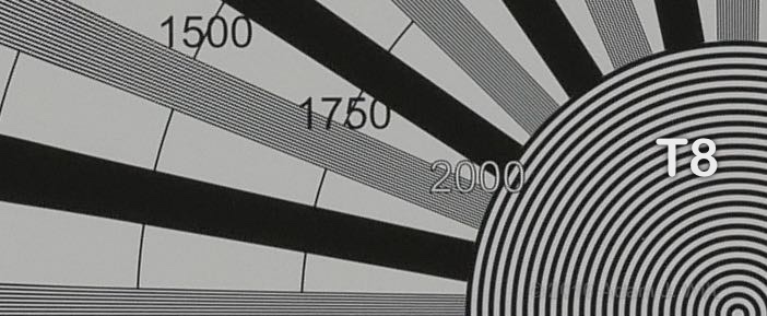

The sweet spot for the 85mm is from T2.8 to T5.6, where its images are razor-sharp. At T2.2 the image is softer, if only slightly; as you close it down to T8 and below diffraction takes its toll. These pix were shot with the full 16×9 frame of a GH4 in stills mode (thus full-sensor width at 4608 x 2592), default sharpening, with no post-processing, and a 1:1 pixel-for-pixel extract was cut out for reproduction here:
Again, the 85mm behaves just like the other Veydras (and all lenses on a MFT sensor will lose sharpness due to diffraction at smaller apertures: ye cannae change the laws of physics!).

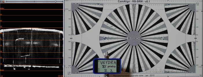

Wide open, there’s some brightness falloff in the corners, maybe 1/3 – 1/2 stop, but close the iris down to T2.8 and the illumination is flat edge-to-edge and stays that way down to T22:

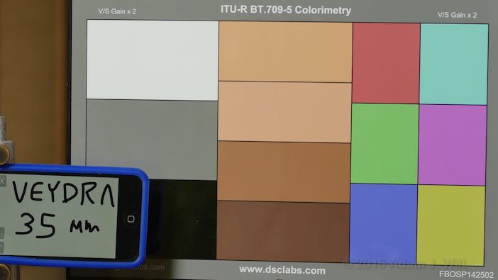

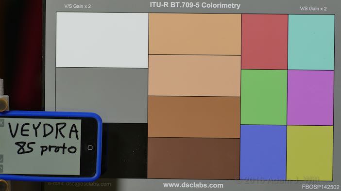

The 85mm is just a shade more magenta in its rendering than the 25mm, 35mm and 50mm primes, but it’s not nearly as magenta as the 12mm and 16mm are yellow. The difference is so minor it’s only barely visible when cutting back and forth between two otherwise-identical shots if you’re looking for it:
[Tripod moved slightly between 85mm shot and 35mm shot, but the lighting (Kinoflo-Diva Lite 400 with K55 tubes) is the same in all three images.]
