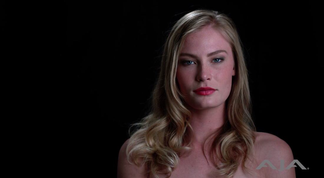

Cion_2.55.23 PM

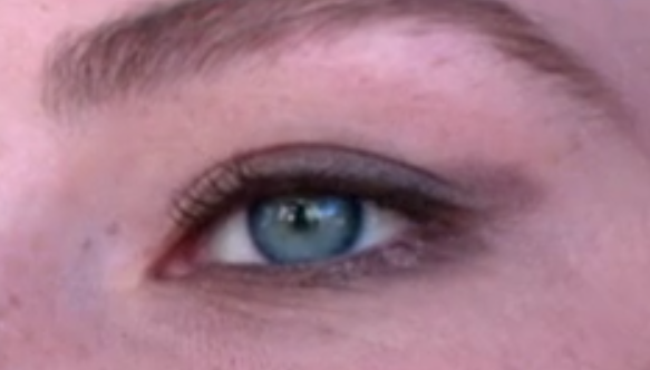

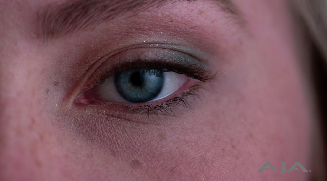

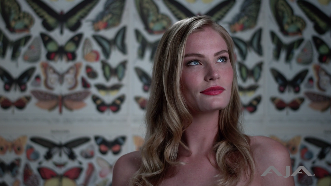

I can’t escape the feeling that this was shot by someone who is primarily a still photographer. Most of these setups feel like still fashion frames with movement in them. There’s nothing wrong with that, I suppose, but it doesn’t feel as if the material is targeted at someone like me: a working cinematographer.
There’s something else going on here that I can’t put my finger on. From the highlight in her eyes the source looks reasonably large, and from the color I’m guessing it’s an HMI that’s either bounced or pushed through a frame of thick diffusion. The model’s face looks magenta, which is not a good look. There’s a hard fill light from the left that’s so far around that it’s casting a hair shadow on her face, but as best I can tell it’s not affecting her flesh tone much.
The Vimeo description says “The studio shots were captured using three point lighting” which is not exactly something you’d boast about to anyone who has been in the business for a while.
It’s hard to make an LED light with just the right amount of green in it (excluding remote phosphor designs), so rather than take a chance on a green spike some manufacturers will overcompensate and pull a lot of green out. Too little green in a light makes it appear magenta. If the light in her eyes was smaller I’d assume she was lit with a tungsten LED panel, as those are most likely to show green or magenta color shifts. My best guess, though, based on the coolness of the background, is that this is lit by an HMI key. (I feel okay using the word “key” in this context because, you know, three-point lighting.)

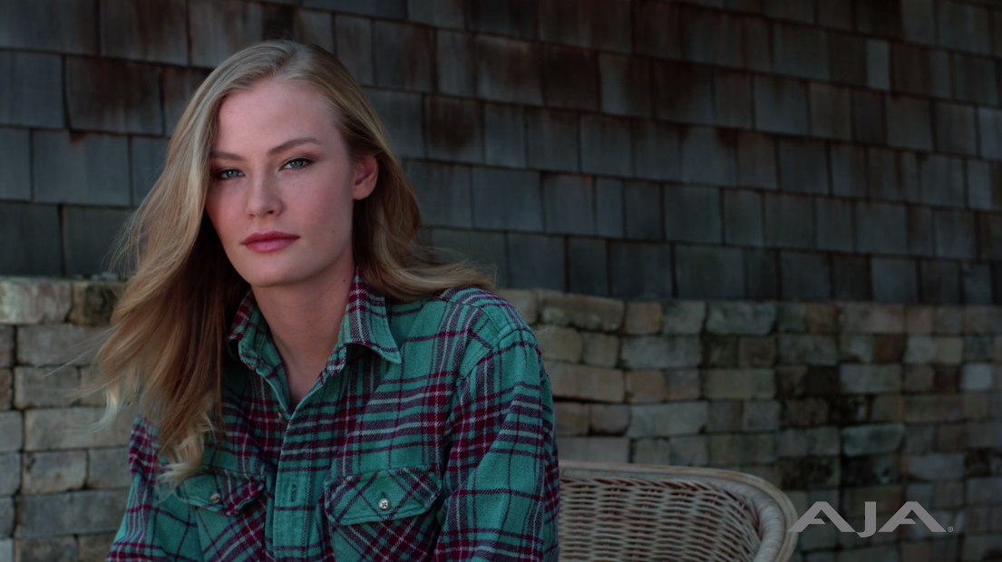

In my article on Panasonic’s latest demo reel I used a color picker to examine the RGB values in images to confirm that the hues I saw were actually present and not a trick of my monitor or my eyes. When I sample this model’s forehead it comes up as RGB 154, 121, 131, and that’s way too much blue for flesh tone. Either the light is blue or the white balance is off, or maybe the camera matrix overcompensates for the lack of red in daylight sources by punching red hard.
The background looks slightly cyan to me, which is confirmed by my color picker (111, 118, 122–not crazy cyan but enough to look cool and not neutral) so there’s definitely something wrong with either the color of the light or the camera’s response to it. This is not something one wants to wonder about while viewing a new camera’s demo reel… and this is only the first shot!
If the warm colors in the background are dull and the neutral tones seem cyan–both of which imply either a poor white balance or an old HMI bulb–why is her face bright magenta? As best I can tell it’s an interaction between the blue light and warm makeup.

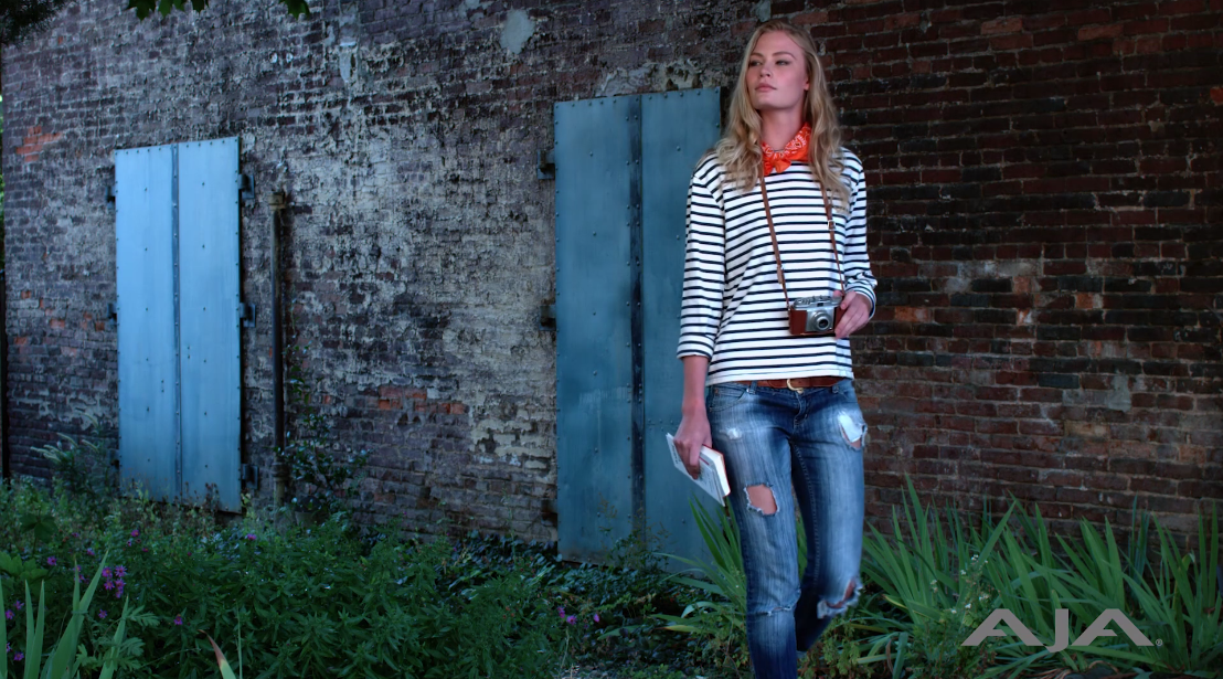

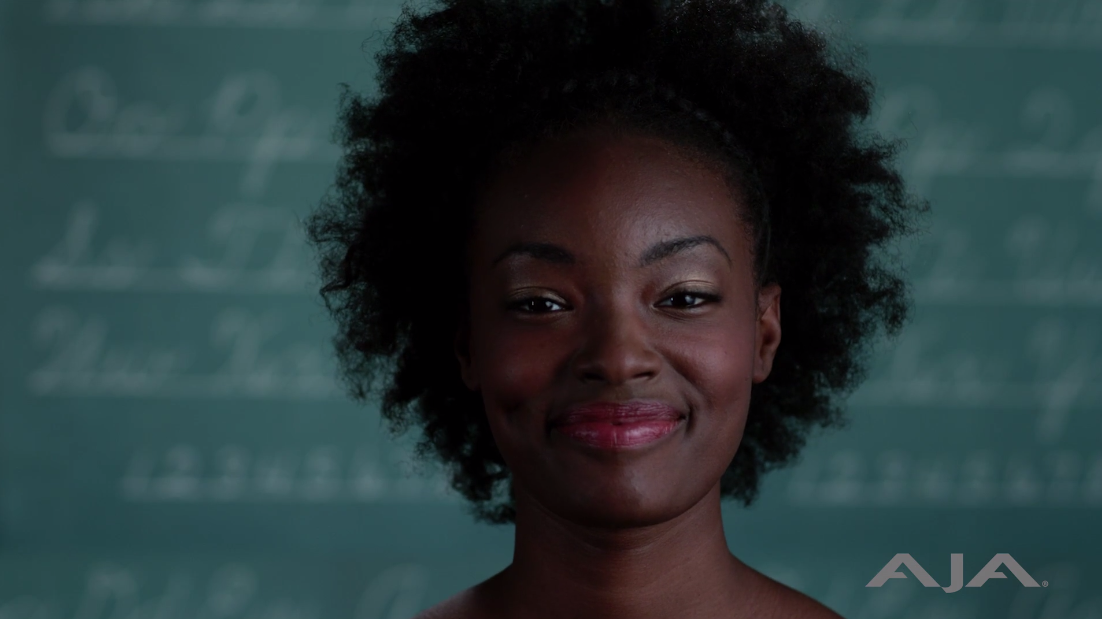

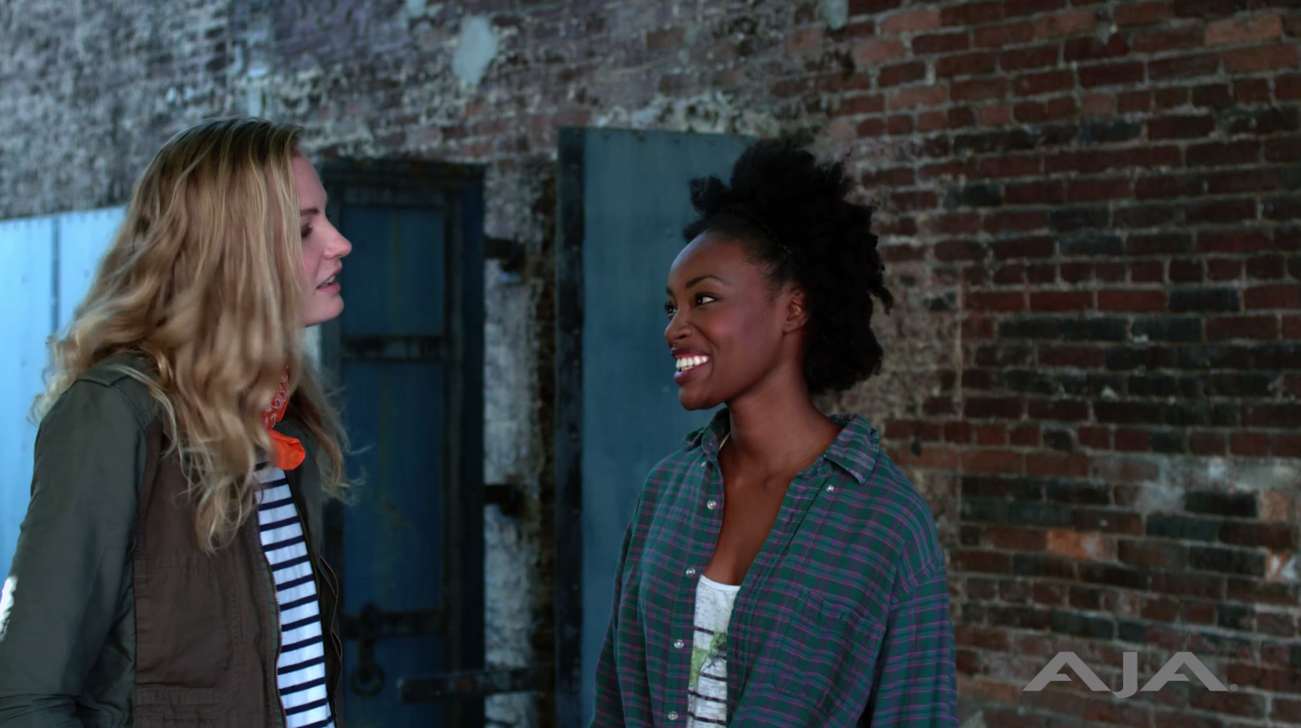

Cion_2.55.48 PM
The colored background and the model’s dark skin make it difficult to see what’s going on here, but the specular highlights in her cheek and forehead feel cool to me. My color picker says that, like the previous model, her flesh tone has more blue in it than green (RGB 97,79,85) and that’s simply wrong for flesh tone. She appears to be lit by the same light as was used for the previous shot. She looks a lot better, though, as dark skin can be lit with a wide variety of colors and still look amazing. Caucasian skin is not that forgiving.

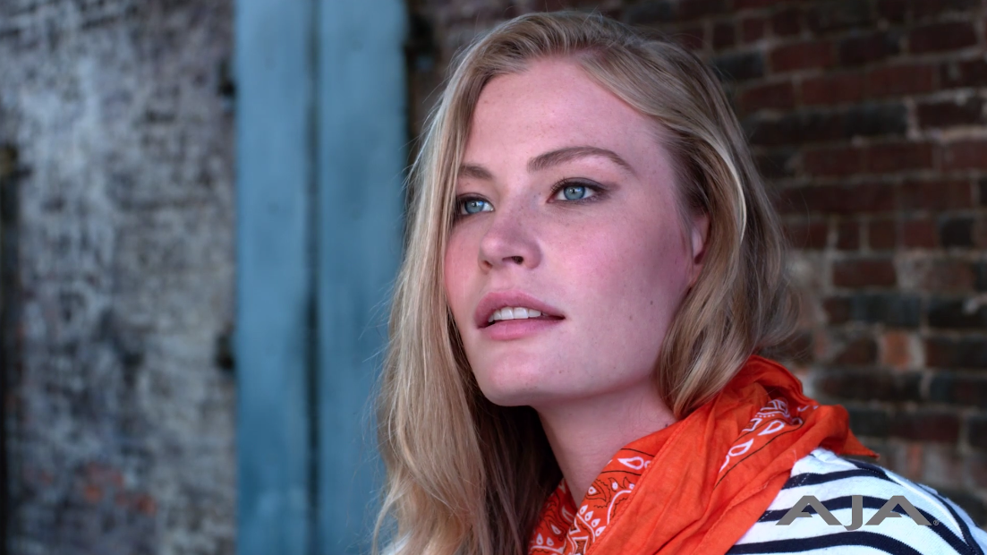

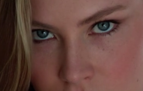

Screen Shot 2014-09-18 at 8.40.33 PM
Why is it that, when she turns to her left, her near check turns rosey red? That’s just not natural. Either she’s wearing a lot of makeup, or that “fill light” from the far left is actually a tungsten light. To find out I zoomed in to the Vimeo HD version of the video as far as I could:

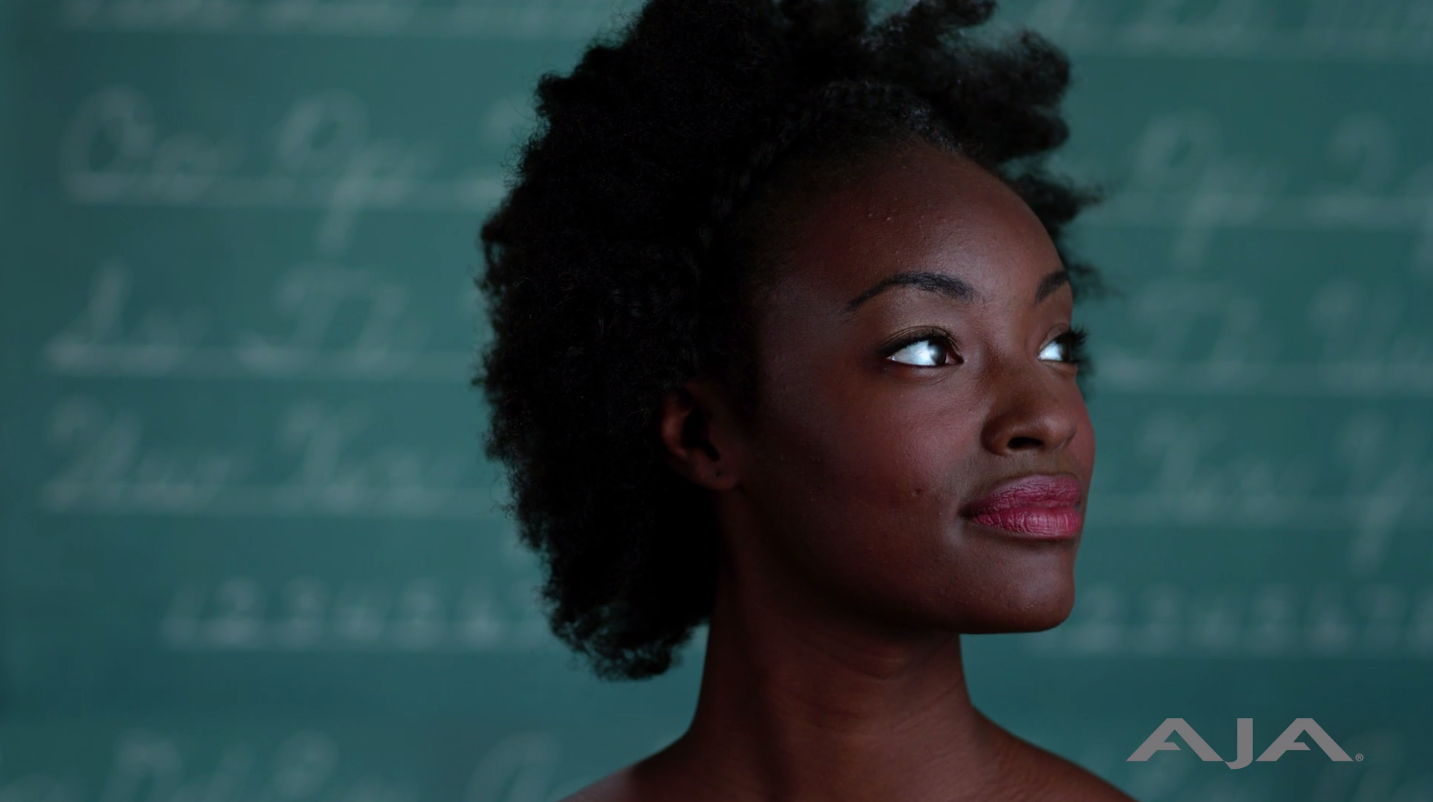

Cion_2.56.34 PM
The lack of a background in this shot helps us see more clearly what’s going on with this model’s flesh tones. She’s nearly purple. Her forehead is RGB 163, 118, 134, which confirms what my monitor seems to be showing me: there’s a lot more blue than green in her skin. (I’m using an NEC display that was calibrated at the factory, so it’s not perfectly Rec 709 but it’s pretty close.) Flesh tone is primarily red and green; there should be very little blue in it. My color picker says that her hair light is very slightly blue,  so this may be a white balance issue.

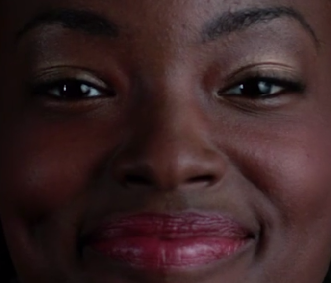

Screen Shot 2014-09-18 at 8.23.55 PM
Out of desperation, I zoomed in on the dark-skinned model’s teeth to check white balance. As her flesh tones look beautifully warm, and the caucasian model’s skin looks like she’s been in the oven a bit too long, and neither of their shirts appear to be a neutral color, I needed something to tell me whether the camera’s white balance was accurate or not. My color picker says her teeth are perfectly white, so it appears that the camera is reasonably white balanced. The skewed colors appear to be either a LUT or matrixing issue.

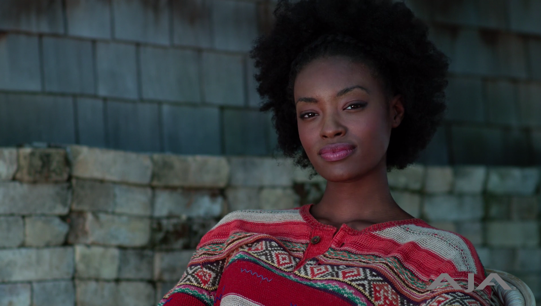

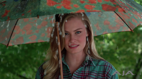

Cion_3.00.03 PMApparently someone managed to round up a bounce card for this shot and stuck it out in some sunlight. The left side of the model’s face is a little warmer and there’s clearly some shape to the light, indicating that it’s not simply ambient bounce off some distant trees. Still, though, her flesh tone has more blue in it than green: I can see that by eye, and the color picker says so as well (RGB 172, 119, 125). There’s less blue present in her flesh tone than in previous shots, at least on the warm side of her face, but there’s still too much.
The cool highlight in her hair implies open sky overhead. And, for open sky, it’s not reading blue so much as cyan. The dark part of the wall at the top of frame has equal parts blue and and green in it (RGB 39, 50, 54) and that’s odd for open sky. Some camera manufacturers like to add a lot of green to blues (or they can’t manage to remove enough green from blues) to the point that skies become a beautiful and dazzling cyan that’s also utterly unreal. I’m wondering if something similar is happening here. I’m not seeing bright blue hues in this footage without seeing a lot of green mixed in at the same time.
Cion_3.01.17 PM
This model’s face is beautifully warmed by the bounced sunlight, although the color picker says that blue and green are at equal levels instead of green leading blue the way it should. My gut says the colors in her shirt should stand out more: the red around her neck is really saturated, but it doesn’t grab me for some reason. It’s certainly red, but I don’t sense any subtlety or delicacy in its reproduction. (It’s also a blueish red, which may be the actual hue of the fabric or contamination from the sky. Again, not a question you want to ask yourself while watching a camera’s marketing demo reel…)
Look how cool the background is, and notice the cyan reflections in her forehead. There’s plenty of skylight contaminating the shot from overhead… and it’s not reading as blue but as cyan.
She also has the darkest hair ever. I see no detail in it at all, even in the parts that should be lit. This could be due to web compression, but still… I don’t see a single instance in this video where her hair has any detail in it unless she’s standing in front of a bright background and the strands are silhouetted.

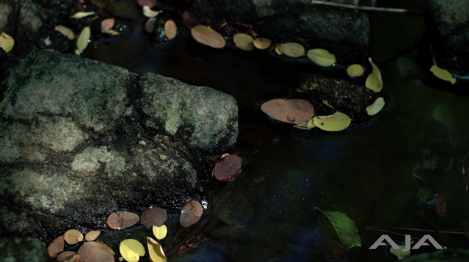

Screen Shot 2014-09-18 at 8.22.31 PM
I can’t help but wonder why every shot so far has taken place in open shade. This model’s hair has almost no detail in it–honestly, the blacks look crushed–and there are no bright highlights to be found. What is the actual dynamic range of this camera? Surely 12 stops of dynamic range is enough to show us some sunlit footage…

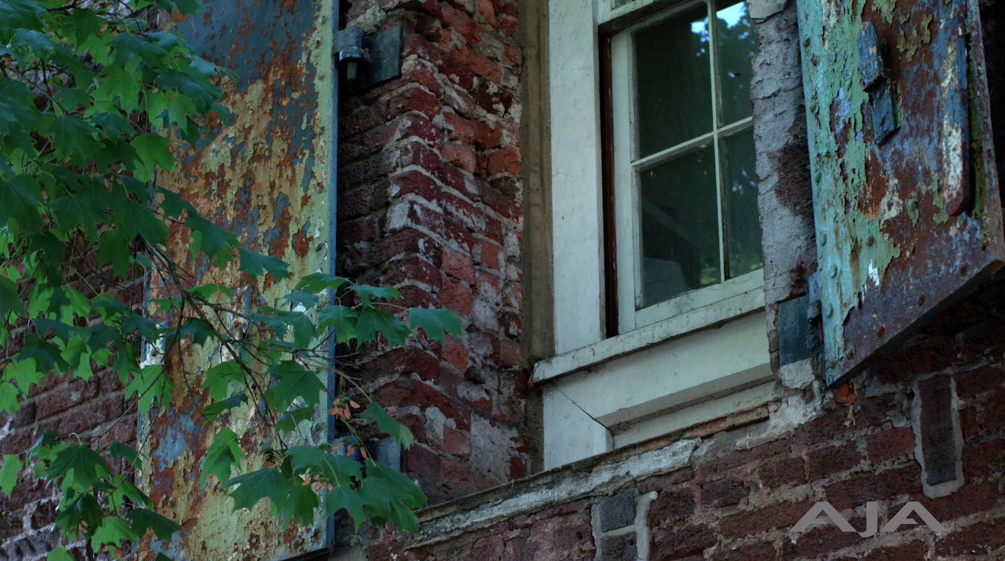

Screen Shot 2014-09-18 at 8.24.29 PM
We don’t know what color any of these things really are, other than the leaves, so… hmmm.

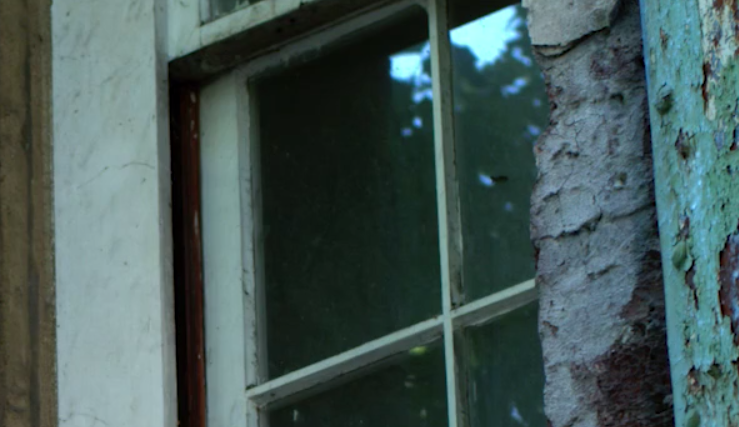

I’d normally assume that the window frame was white, but it’s on the greenish side of cyan. This seems to play into my theory that this camera renders saturated blues as greenish, as I’d normally assume that a white window frame would appear bluish under skylight. Maybe it’s actually a greenish white…?
There’s a patch of sky reflected in the top of the window, and when I zoom in…
Screen Shot 2014-09-19 at 7.52.06 AM
That’s sky, and it’s definitely not blue. In fact, my color picker says that both the blue and green channels are clipped. There’s no subtle roll-off into overexposure here, and no gentle desaturation of highlights as they approach clip. Instead, something that’s supposed to be a pale blue color–or at least a neutral clipped white–is positively electric cyan. That’s just wrong.

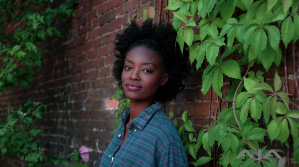

Cion_3.05.18 PM
This is the nicest flesh tone so far. When I went in with the color picker to find out why I discovered that, for only the second time in this video (and the first time for a full face), the amount of blue in her flesh tones didn’t exceed or match the amount of green (RGB 133,93,83). Her flesh tone looks fairly nice.
The Vimeo description says that this is the only exterior shot that employed a light. There does seem to be some sort of light source in play here:

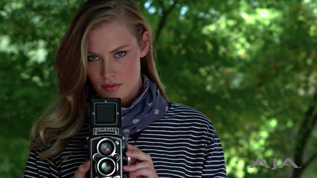

Cion_3.01.02 PM
Here’s another still photograph in motion… literally. It’s interesting how her flesh tone looks pretty good in these two images, and they’re also the only images where it’s obvious that the sun is present. It seems that this camera can resolve flesh tone reasonably well in the presence of neutral daylight… so why was everything else shot under open sky? What is the true dynamic range of this camera?
Screen Shot 2014-09-19 at 9.13.22 AM
It looks like there’s something bouncing a little sunlight into her face in this shot. I don’t see the pinpoint of light in her eyes that I saw in the previous shot, which was noted as the only exterior shot lit with an actual light, but there’s no effective difference between flesh tones in this shot and the previous one. There does seem to be something lighting her, but it’s impossible to determine whether it’s a sunlit bounce or a small light through diffusion.

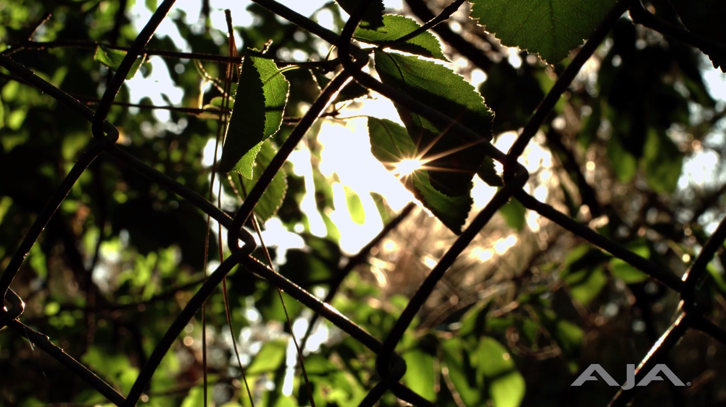

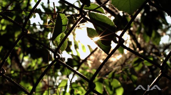

Note that there are some clipped highlights in the leaves behind her…

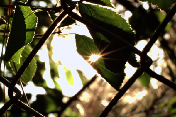

Screen Shot 2014-09-18 at 9.04.37 PM
This camera doesn’t seem to handle clipping gracefully. I don’t see any exposure or saturation roll off: there’s dark green, light green, a ring of yellow, and then white. Blech.
Some of this ringing could be due to 8-bit web compression, but if so I’d have worked a bit harder to fix it or use another shot. And 8-bit compression would likely have eliminated some of the delicate transitions between tones, but that yellow ring doesn’t look like a compression artifact to me. That’s indicative of a color channel clipping in the camera.
Last time I saw something like this was in footage shot by a Panasonic AF-100.

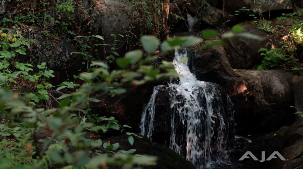

Screen Shot 2014-09-18 at 8.28.39 PM
Okay: tell me if you see a difference between this waterfall and the next…

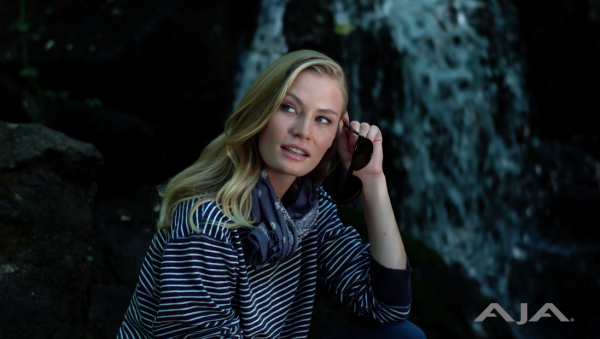

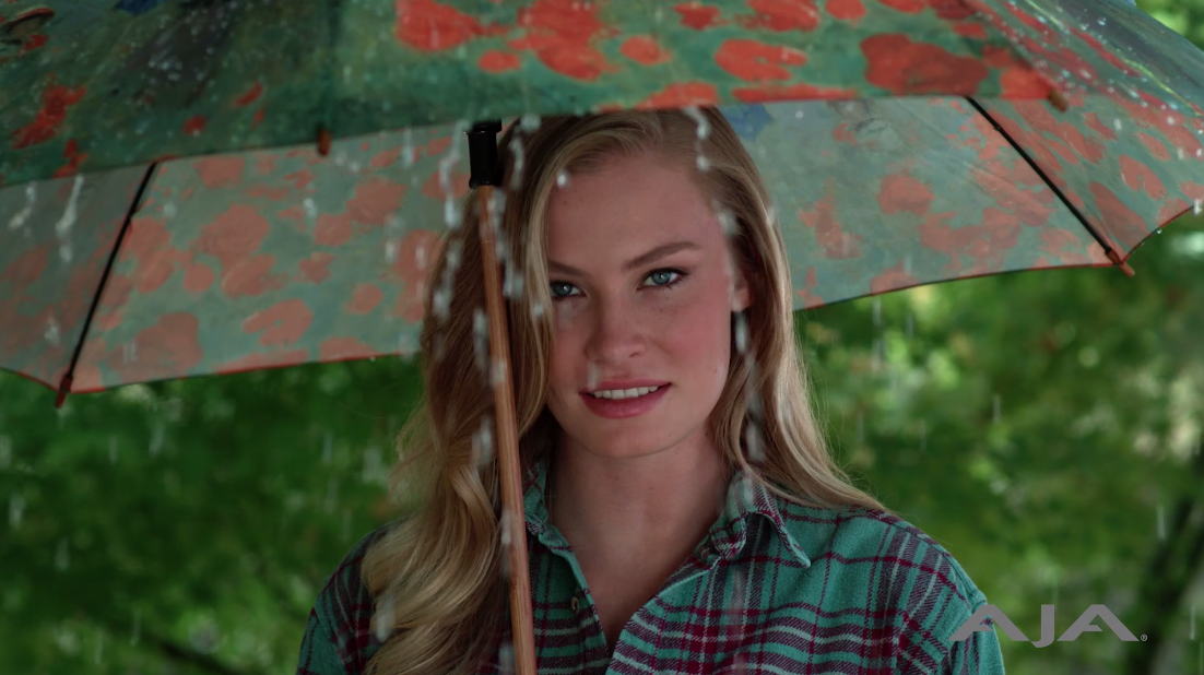

Cion_3.06.49 PM
One side of her face looks natural, as it does in the previous two sunlit shots, so I’m guessing that there’s some bounced sunlight coming in from frame right. (It can’t be a light… AJA says only one light was used in shooting an exterior, and we’ve already covered that shot.) But… her hair is green and the water in the background is cyan, so my guess is they white balanced to the bounced sunlight and let the rest go. This seems to show that the camera has a hard time separated greens from blues, as the water in the background is definitely cyan even though it is lit by blue skylight.
It’s clearly the same waterfall in both images. One was apparently white balanced for skylight and the other for bounced sunlight, but wow… she looks like she’s hanging out in a fluorescent-lit laundromat in the woods.
Her scarf is (dull) blue, and her shirt seems to be (dull) blue, but her hair and the water behind her are an almost electric cyan. Is this really the kind of image you want to show in a marketing demo? (Spoiler: NO.)
