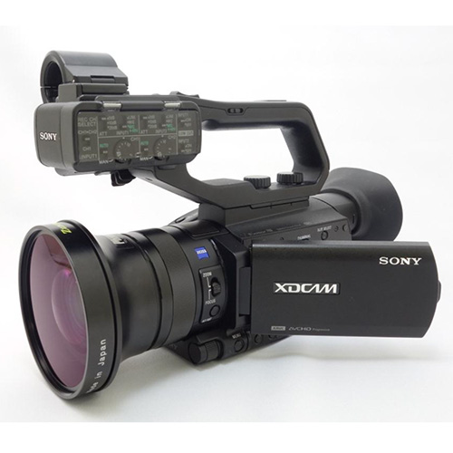

Just saw this, Zunow came out with an X70 0.7x Wide Converter, the WCX-70.
