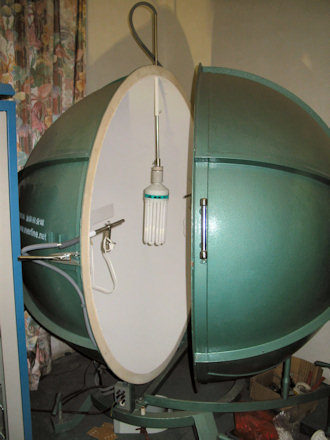

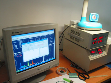

The only real way to reliably test discharge and LED color temperatures (unfortunately) is with a spectroradiometer and integrating sphere. All those sources with a correlated color temperature (CCT) can't necessarily be accurately read with a simple color temperature meter. Most of those meters were made to work well with full spectrum lighting like tungsten. They don't understand the spectrum of anything with a correlated color temperature. When we want to accurately read the color of a bulb or LED, we have to take it to a testing facility since an integrating sphere isn't found just anywhere and they aren't portable either as you can see below...

Fabulous! I've never seen a picture of the sphere before.
I concur with your statement regarding the fidelity of readings made with a spectroradiometer versus a color temp. meter.Indeed, this reveals that the illuminations industry simply doesn't adhere to strict standards for measurement or labeling of light sources. It's a hugely frustrating issue that has had me at odds with the IEEE, and NIST at times. Surely there must be ISO compliant manufacturers?
