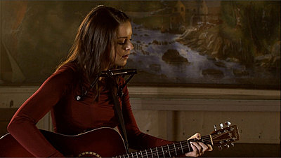

The girls from our camera shootout asked for a version of their song without all the camera test stuff. The shots from the shootout were static locked down on tripods so it didn't seem very interesting. For fun i dropped to a 1024x576 pal timeline and did "pan and scan" to move around the image and create motion from the two static shots.
Youtube destroyed the image and as noted before, our gh4 footage was kinda noisy to start with, but the footage looked pretty good in the NLE and it was still an interesting thought experiment. You could absolutely use the gh4 footage for interviews to give you a CU and wide at the same time. Dropping to 720 (or SD) you could get a pair of closeups from a single 4k wide if the two people weren't miles apart and the frame too wide.
Anyways, ugly resolution aside, here's the silly "frame it in post" version of the test video.
Again, this is a locked down wide and a locked down medium shot. All zooms/pans/tilts are added in post. Cheers! oh, fyi, i never scale larger than 90% in the video so the image holds up ok.

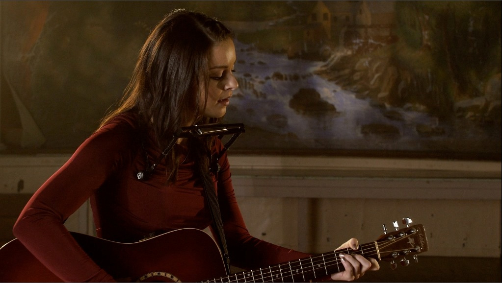

heres a grab from qt to show the "before youtube" quality.http://www.dvinfo.net/forum/attachme...1&d=1397782427

I just used premier for that. I applied temporal "ease" to the motion and scale keyframes. also, i adjusted some of the paths to be something other than a straight line. It seemed that a little bit of drift made the moves seem a bit more real.
