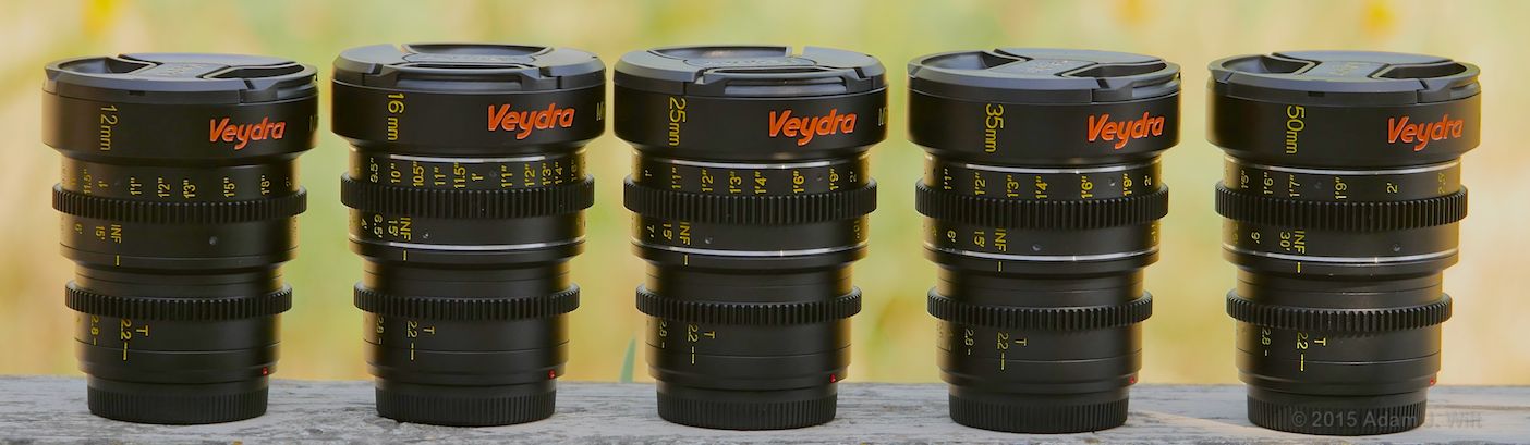

Veydras are serious cine primes for micro four thirds cameras like the Panasonic GH4 and the Blackmagic Design Pocket Cine Camera. The Veydra project went public last November; I tested prototypes of the first four lenses—16mm, 25mm, 35mm, and 50mm—in December; and customer shipments commenced in February.
Only one piece has been missing from this puzzle: the 12mm. Veydra showed a prototype 12mm in a private suite at NAB 2015, and then sent it to me for evaluation.

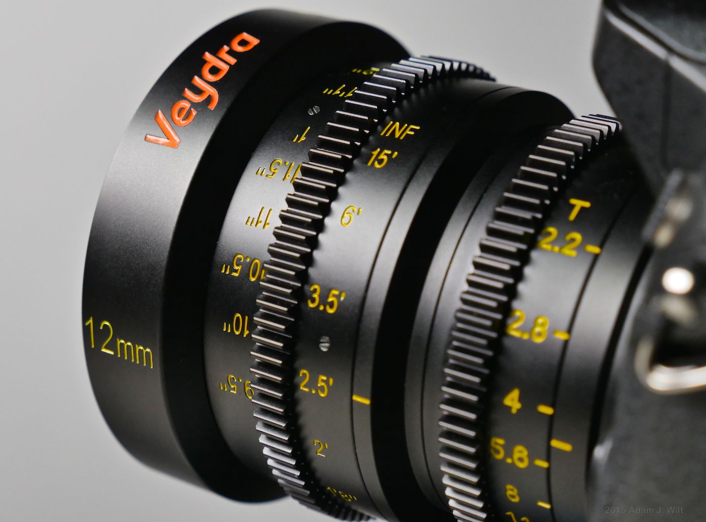

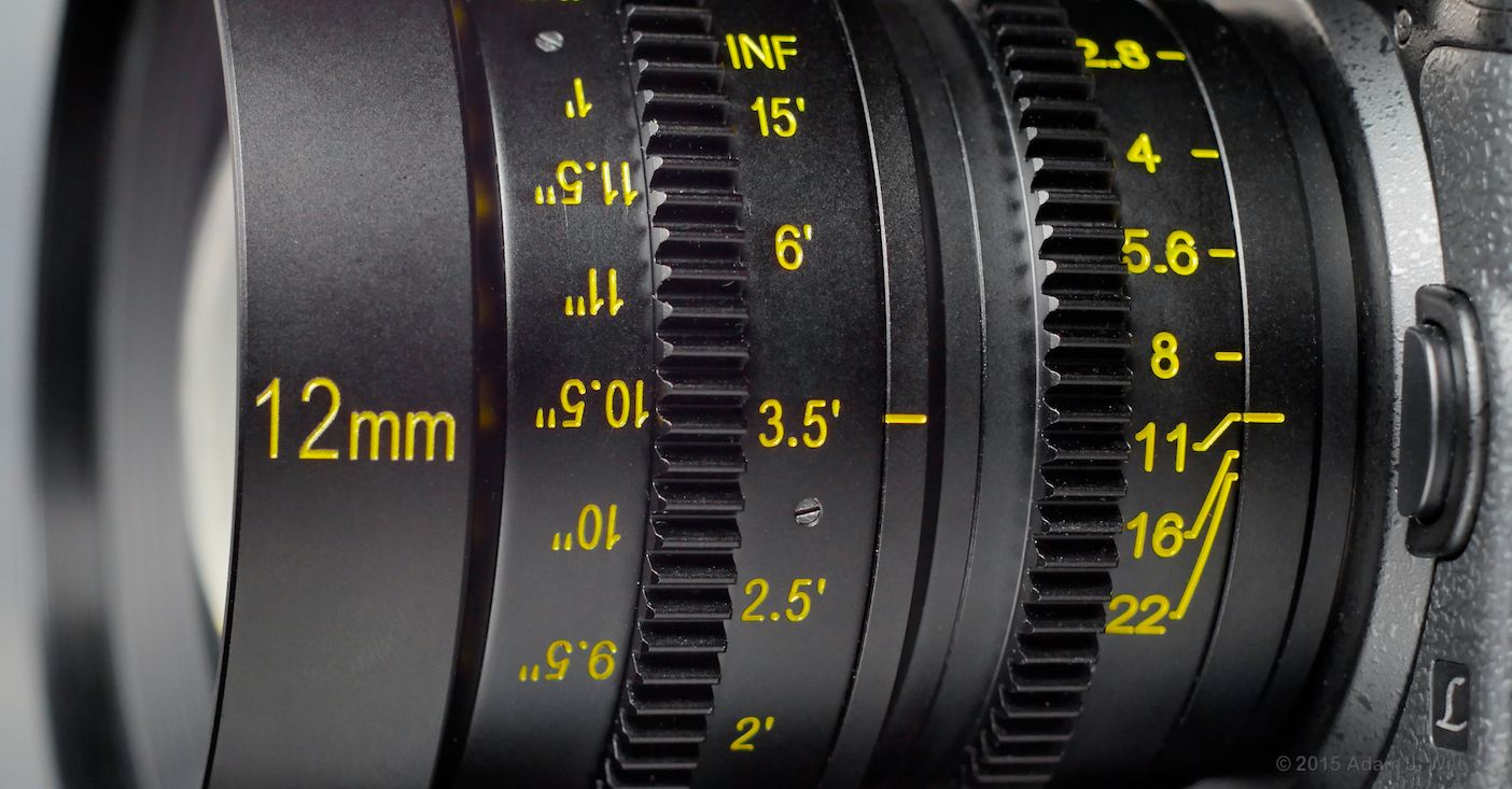

The 12mm looks very much like the other Veydra primes, though this particular prototype is 4mm shorter than my four production Veydras, and its markings are somewhat smaller. The prototype also lacks the chromed grooves on the leading and trailing edges of the focus ring.
Veydra supremo Ryan Avery warned me that this sample, like previous prototypes, is a bit rough around the edges, but it seemed perfectly fine: both focus and iris turned very smoothly, with no stiffness or grinding.

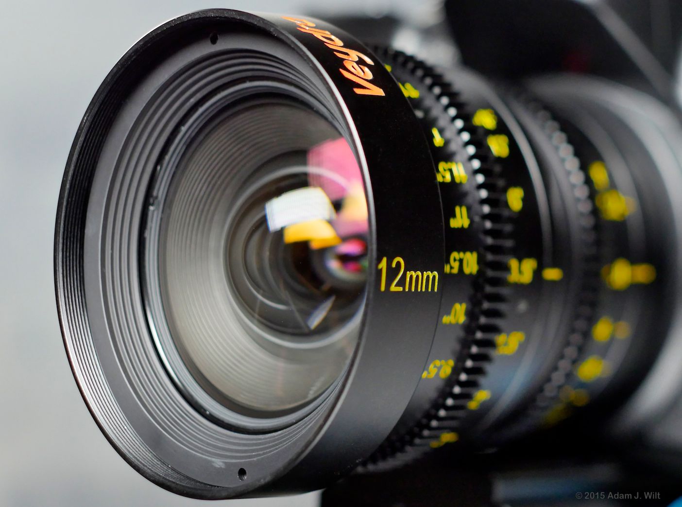

The 12mm has a rather large, convex front element.
Apertures below T11 get rather crowded, but you probably don’t want to close that far down anyway due to diffraction losses.
